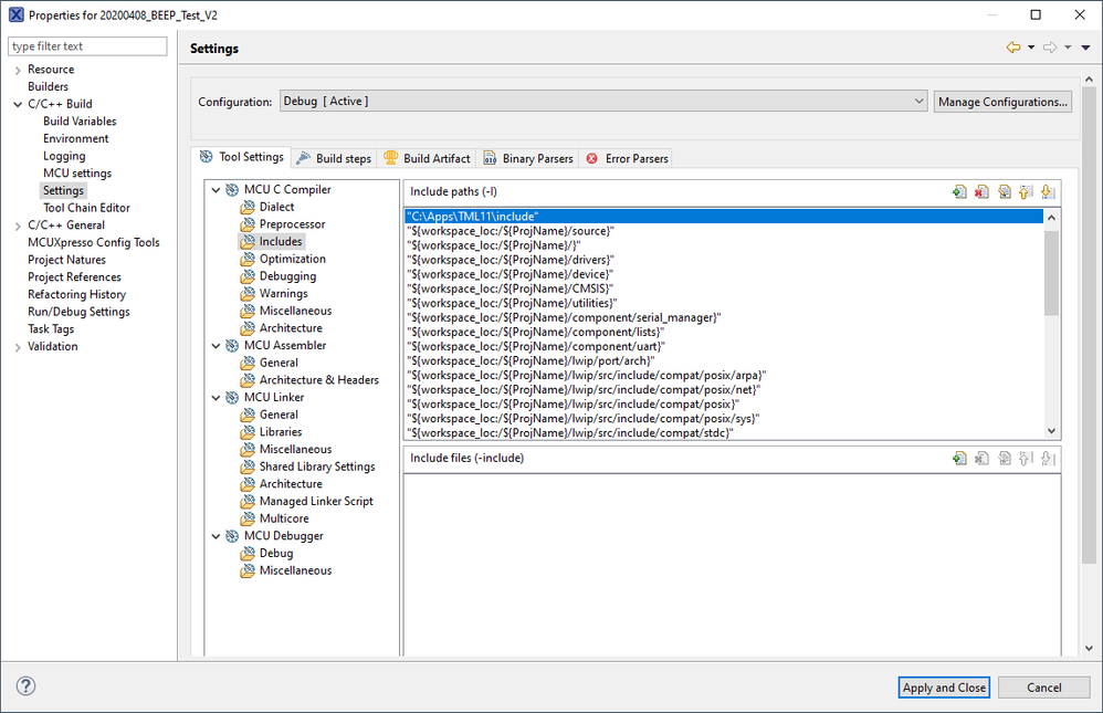

I worked through the instruction Creating and Linking to Library Projects and searched in forums and the internet to integrate the library in my project. I think, this part work fine, because I can include the library with
Therefore I changed the properties for example under c/c++ build -> settings -> tool settings -> MCU C compiler -> includes
But I'm not sure which library search path I should use under MCU-Linker -> librarys, so I tried all possibilities: the dll's under TML11/bin/win32 and TML11/bin/x64 or the lib's under TML11/lib/win32 and TML11/lib/x64 (see attachment). I think the last one is the best, because my laptop has an x64 architecture (hp elitebook 850 G5) and libs better for the IDE, but I'm not sure because no way works.

Your target is a LPC54618 which is an ARM Cortex-M4 device. This is a 'bare metal' device - it has no software, no operating system - nothing - until you write the code and download it to the device.
The MCUXpresso IDE runs under Windows (or Linux, or Mac) and is known as a a cross-development environment. That is, you use it to compile code to run on the target - in your case the LPC54618. It cannot do anything with host based software, such as libTML, because that is built to run on Windows (or Linux, or Mac...).
In theory, it would be possible to take the source code for libTML and 'port' it to run on the LPC54618 - but, this would be a HUGE effort - libTML relies on a sophisticated operating system to provide all of the services it needs (such a TCP/IP).
DLL (Dynamic Linked Libraries) are specific to Windows (although Linux and Mac have an equivalent, but different mechanism, called dynamic libraries). This is where an operating system dynamically loads the library at run time (normally on-demand) and 'fixes-up' the calls from your application to the correct place in the library. This is done so that many application (potentially running concurrently) can use the exact same code without it needing to be loaded for each application. On Windows, Linux and Mac, this uses Virtual Memory and a demand paged memory management. None of this is available on a LPC54618 - or any other embedded microcontroller (MCU).
MCU's do support statically linked libraries. This is where the library is linked into your application, so it can all be downloaded into your device. This is the type of library supported by MCUXpresso (and IAR, Keil etc).
__declspec is a Windows specific enhancement to C/C++ for the use of DLL's. There is no way to use this for the LPC54618. There is not even an equivalent concept.
You can include external (statically linked) libraries in MCUXpresso, but the libraries have to be specifically written for, or ported to, ARM Cortex-M4 (or M3, or M0 etc) devices.
