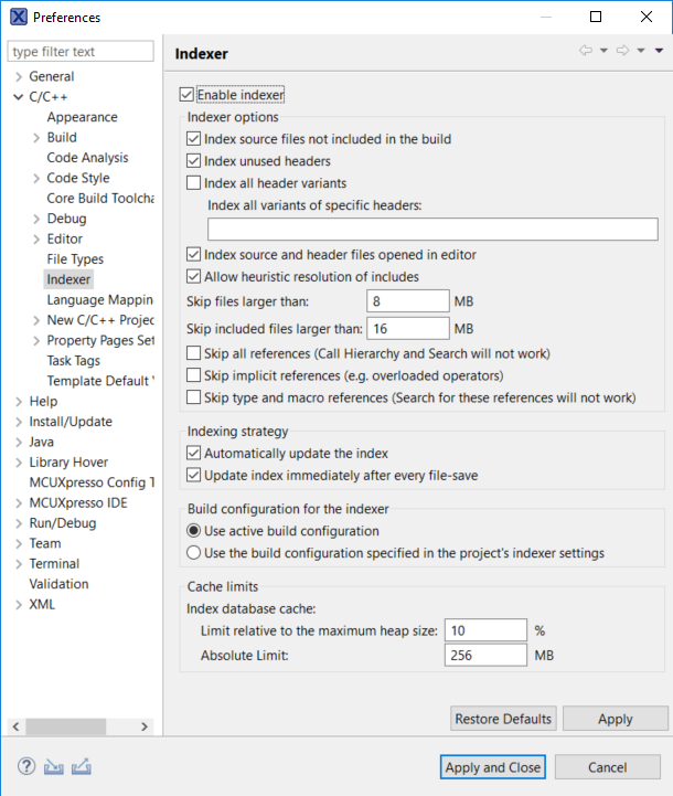

Hi Erich,
Thank you for getting back to me on this. My indexer settings are below.
Strangely if I import an example project from the SDK, indexing works. Have I somehow managed to corrupt a setting?
Thanks again,
Alan

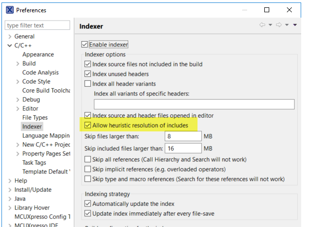

not sure if this will solve it, but: I recommend disabling this option:
The heuristic is really only heuristic (or: kind of guessing) and can result in incorrect indexer information for more 'complex' projects. It might work fine for standard SDK examples as they are not really complex.
And you might disable 'index source files not included in the build' and 'index unused headers' too. Below is what I typically use:
