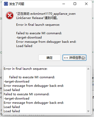

Thanks, but I failed to execute MI when I was debugging after building

Thanks@ RaRo, but I failed to execute MI when I was debugging after building
