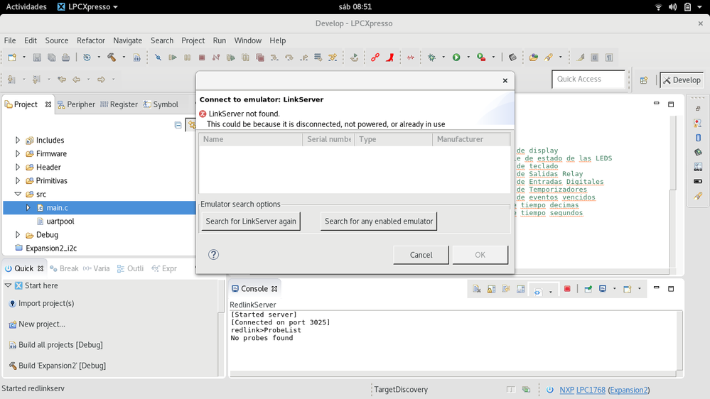

But, if I try to debug with my old installation LPCXpresso v8.2, after the seek for any enabled emulator, I can debug without problems. Picture with LCPXpresso:
After pressing the button "Search for any...":

We have managed to replicate your problem.
MCUXpresso IDE (and LPCXpresso) uses a background server, the 'link server' to manage debug connections via multiple probes.  It is visible in e.g. 'ps auxw | grep redlinkserv'.  It is this service to which you issued the 'ProbeList' command - which is how the IDE locates the Link1 probe that is part of your LPC1769 board.
The link server comes and goes, but is more persistent in MCUXpresso IDE than in LPCXpresso.  In MCUXpresso it can be terminated using the new 'Clean Up Debug' icon on the toolbar.  It will simply be restarted when needed.
Your LPC1769 board's debug firmware is booted using the 'dfu-util' utility that is part of Debian/Ubuntu.  An unbooted probe can be seen in the output of 'dfu-util -l'.  Once booted 'lsusb' will show a different entry for the probe.  The IDE detects whether the firmware is booted and reboots it if necessary.  We believe that this part of the IDE is working perfectly in your case.
The link server detects only booted probes.  It seems that, in your case, that if the probe is power cycled the IDE reboots the firmware but the link server does not register the new probe (even though it did before the power cycle).
Can you confirm that - when the probe discovery dialogue can not find the probe - you can cancel the discovery; then use the 'Clean Up Debug'; then find that the probe is then discovered properly?

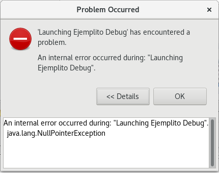

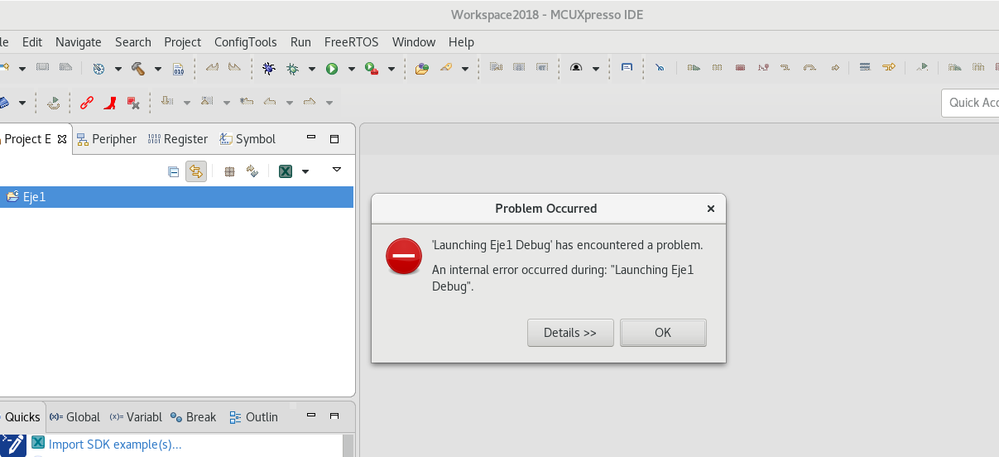

marianovedovato
Dear support, thank you so much again for your reply.
I had to upgrade to MCUxpresso v10.2 since the "Clean debug button" didn't appear (or I can't found it) in my older 10.1 version.
And, what now?
When I try to debug my lpc1769 stick, the following message appears:
I tried to do a new Workspace, new project but the final result is the same.
I have seen before this error weeks ago, and I remember that the solution was do a downgrade to 10.1 version (note that I am in a kind of infinite loop :smileyhappy:) but the new problems that rised, were regard to a this discussion.
Believe me, my next discussion was going to be the java.lang.NullPointerException.
I will wait for your comments!
