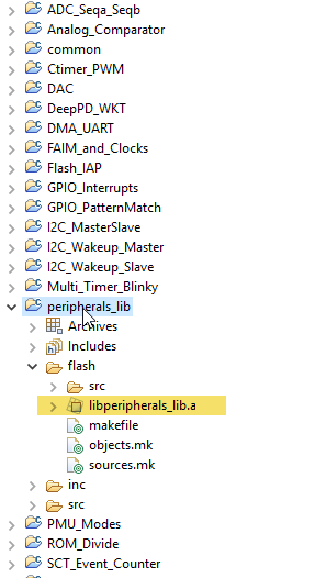

Installed Examples from inside MCUX IDE, see attached 'Pic01'.
Installed all Examples from inside MCUX IDE, see attached 'Pic02'.
When Build 'Multi_Timer_Blinky' the IDE, Console view, give me problems, see attached 'Pic03'.
Same probles now, Problems view, see attached 'Pic04'.
Please, some more expert than I (I'm starting with this device and IDE,...) can teach me about what could be happen?
Many thanks.

Hi Luis,
Please make sure that the libperipherals_lib.a file is present inside the flash folder of the peripherals_lib project:
Also, I would recommed that you follow this video for more inforamtion on how to run the LPCOpen examples:
MCUXpresso IDE - Using LPCOpen Examples |NXP
Hope it helps!

HI again Carlos and many thanks your suggestions, very valuable for me.
I explained in my other post what has been the problem. Now it's working and compiling and running any example.
Best Regards
