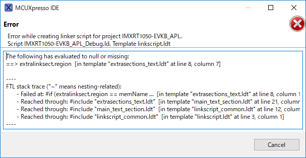

I'm using IMXRT1050-EVKB with SDK v2.4.2 and IDE v10.2.1.
When I upgrade My project to SDK v2.5.0 and IDE v10.3.0, Linkerscript Error occured as follows.
Q. Where is "extrasections_text.ldt"?
Linker Setting is as follows.
And Build error message is as follows.
Building target: IMXRT1050-EVKB_APL.axf
Invoking: MCU C++ Linker
arm-none-eabi-c++ -nostdlib -L"C:\MCUX_workspace\v1030\IMXRT1050-EVKB\IMXRT1050-EVKB_APL\libs" -Xlinker -Map="IMXRT1050-EVKB_APL.map" -Xlinker --gc-sections -Xlinker -print-memory-usage -Xlinker --sort-section=alignment -mcpu=cortex-m7 -mfpu=fpv5-d16 -mfloat-abi=hard -mthumb -T IMXRT1050-EVKB_APL_Debug.ld -o "IMXRT1050-EVKB_APL.axf"
c:/nxp/mcuxpressoide_10.3.0_2200/ide/plugins/com.nxp.mcuxpresso.tools.win32_10.3.0.201811011841/tools/bin/../lib/gcc/arm-none-eabi/7.3.1/../../../../arm-none-eabi/bin/ld.exe:IMXRT1050-EVKB_APL_Debug.ld:0: syntax error
collect2.exe: error: ld returned 1 exit status
make: *** [makefile:131: IMXRT1050-EVKB_APL.axf] Error 1

The most likely reason for this error is that one or more of the names of the memory regions specified in the "Extra linker script input sections" entries of the Managed Linker Script page don't match the actual memory regions listed in the memory configuration for your project (in the MCU settings). "NOCHACHE" in particular looks suspicious.

I have coinfirmed Memory Configuration editor, the setting had be initialized.
Once I set it again I can build it.
