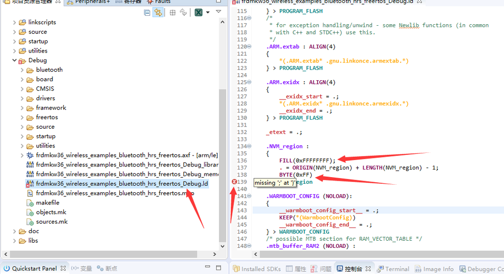

I am using MCUXpresso IDE. I had import frdmkw36_wireless_examples_bluetooth_hrs_freertos, there is a syntax error in frdmkw36_wireless_examples_bluetooth_hrs_freertos_Debug.ld:
Another problem. In line 136 "FILL(0xFFFFFFFF);" there is a ';', but in other codes:

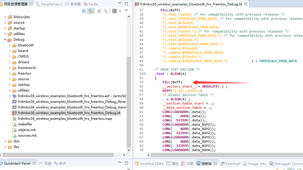

In line 54, "FILL(0xff)" there is no ';'. Why they are different?
2,210 Views
lpcxpresso_supp
Since the project is built successfully, the problem comes from the linker script editor awareness - it doesn't seem to be able to cope with the use case described here. We'll look into this. Thanks for the report.

Hi Mo, I hope you're doing well!
The Linker Scripts used by the connectivity stacks (for example, BLE) use a custom syntax, and are automatically managed by MCUXpresso.
Because of the custom syntax, MCUXpresso seems to detect some errors in the file, but they do not cause issues during compilation, and the build should complete successfully.
Please let me know if you need any more information.
