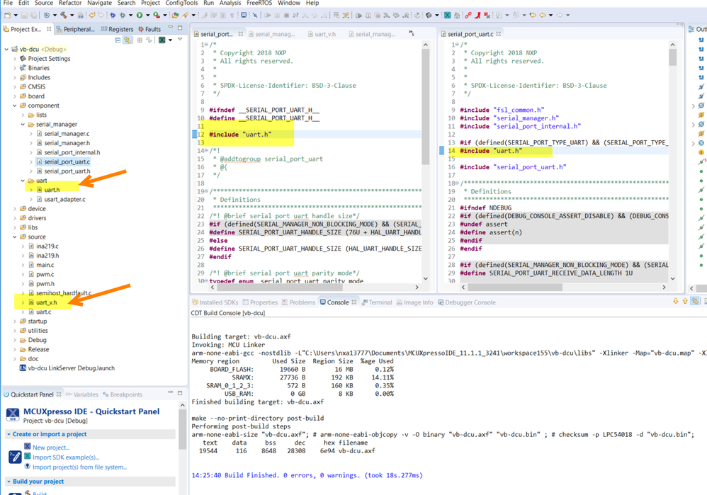

I use an LPC54018 baseboard with IoT module on it. My project is based on lpc54018iotmodule_i2c_interrupt_b2b_transfer_master example, and I want to use UART4 (present on Shield connector) additional to that.
So I took the lpc54018iotmodule_usart_interrupt example, changed that to use UART4 and it worked fine.
Next I copied the specific parts or UART4 and copied it to the lpc54018iotmodule_i2c_interrupt_b2b_transfer_master base project.
When I compile my project it gives the following error:
In file included from ../utilities/fsl_debug_console.c:54:
/Users/raymond/MCUXpresso/54018/vb-dcu/component/serial_manager/serial_manager.h:124:2: error: #error SERIAL_PORT_TYPE_UART, SERIAL_PORT_TYPE_USBCDC, SERIAL_PORT_TYPE_SWO and SERIAL_PORT_TYPE_USBCDC_VIRTUAL should not be cleared at same time.
I tried lots of things but I can't get rid of the error.
Somebody please help me?

Hello Raymond,
Because in your project, there are two header files use the same  name "uart.h",
I change one of them to uart_v.h, and pay attention to includes the right header files in serial_port_uart.c and
serial_port_uart.h :
Then build, there is no error.
Hope it helps,
Alice

mail8
It helps???
YESSS YOU ARE TOP!!
How easy it can be.
Thank you very much!!
