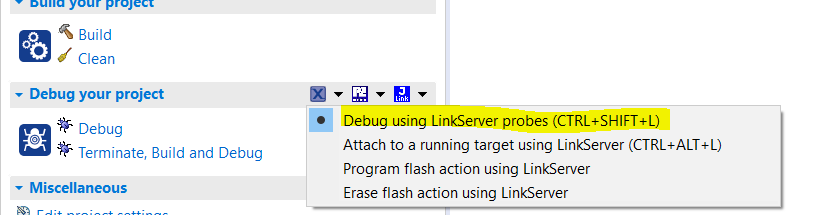

Hi there,
have a look at this screenshot of the Quickstart Panel:
I don't know when MCUXpresso IDE decided to use the keyboard shortcut Ctrl+Shift+L to run "Debug using LinkServer probes" but it definitely clashes with Eclipse's default configuration that assigns this key combination to "Show key assist dialog".
Additionally, the assignment to "Debug..." can not be changed in preferences. It is not even listed there!
Please advise.
2,084件の閲覧回数
lpcxpresso_supp
The Quickstart Panel debug shortcuts were introduced in MCUXpresso IDE v10.2.0. Anyway, thank you for reporting this clash. We'll investigate changing the shortcuts in a future release.
