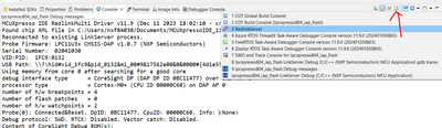

Is there a way of not blanking the console window when the SEGGER terminal starts? It would be nice if all the debugger start up and uploading info persisted in one console tab and the normal debugger semihost/output etc was in another tab. But I would be happy if it just didn't blank it.
I.e. This is shown after all the previous gdb and segger script reset and upload info has been cleared:
Executed SetRestartOnClose=1
[MCUXpresso Semihosting Telnet console for 'McuEmbedWhiteChip JLink Debug' started on port 58171 @ 127.0.0.1]
SEGGER J-Link GDB Server V7.94k - Terminal output channel

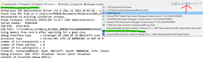

Hello, my name is Pavel, and I will be supporting your case, I reviewed your question, and I found this information.
You could change the console, and pin.
other way could be saving the LOG.
Let me know if this does not work for your application.
