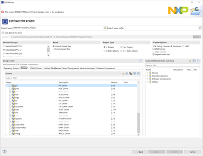

2,147 Views

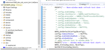

danielchen
There is a wdog demo in latest SDK that demonstrate the SDK wdog driver.
You can refer to it.
2,142 Views
CarlFST60L
Senior Contributor II
When I load the example its an empty project. Can you attach it? I'm not sure why all project examples except wdog work on my side build. There is a problem with the sdk because they all work except that single example.
