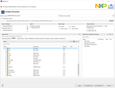

I have used a couple of the SDK examples no problem on the latest K64 SDK in the latest MCUXpresso.
The WDOG example however is just a blank project with nothing in it
The issue is I have configured the watchdog and enabled it in my K64 project without an example and the watchdog fires before it ever gets to main (during bss init).
I have no problem with any other examples other than WDOG, and I really need to be able to do a simple task like use the watchdog without it firing before main is running.

And there is nothing about a watchdog in boot peripherals, and the K64 header has
#ifndef DISABLE_WDOG
#define DISABLE_WDOG 1
#endif
no example I have have the watchdog enabled, and enabling doesnt work using the driver...

When I load the example its an empty project. Can you attach it? I'm not sure why all project examples except wdog work on my side build. There is a problem with the sdk because they all work except that single example.
