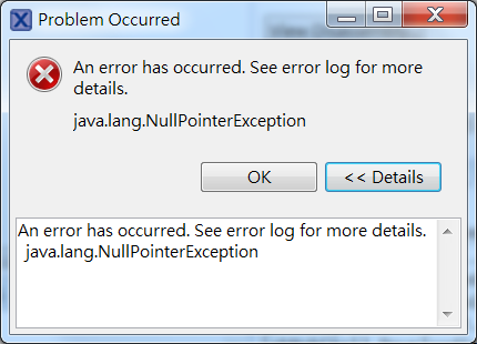

When I click exit, MCUXpresso always show Java.lang.NullPointerException error message.
And I can't shot down or exit MCUXpresso

Could you post the .log file insider your workspace .metadata folder? Usually that log file contains useful information and the stack trace to identify what the problem is.

please try patched plugin in the link bellow. Please do following:
  1. close the MCUXpresso IDE
  2. do a backup of the plugin com.nxp.swtools.periphs.gui_0.0.1.201711131454.jar located typically here: c:\nxp\MCUXpressoIDE_10.1.1_606\ide\plugins\
  3. replace it with this https://mcuxpresso.nxp.com/staticdata/com.nxp.swtools.periphs.gui_0.0.1.201711131454.jar
  4. start IDE again
Please let me know if that helped with the Null Pointer dialog.

It's good, no show error message again when the MCUXpresso IDE close.
