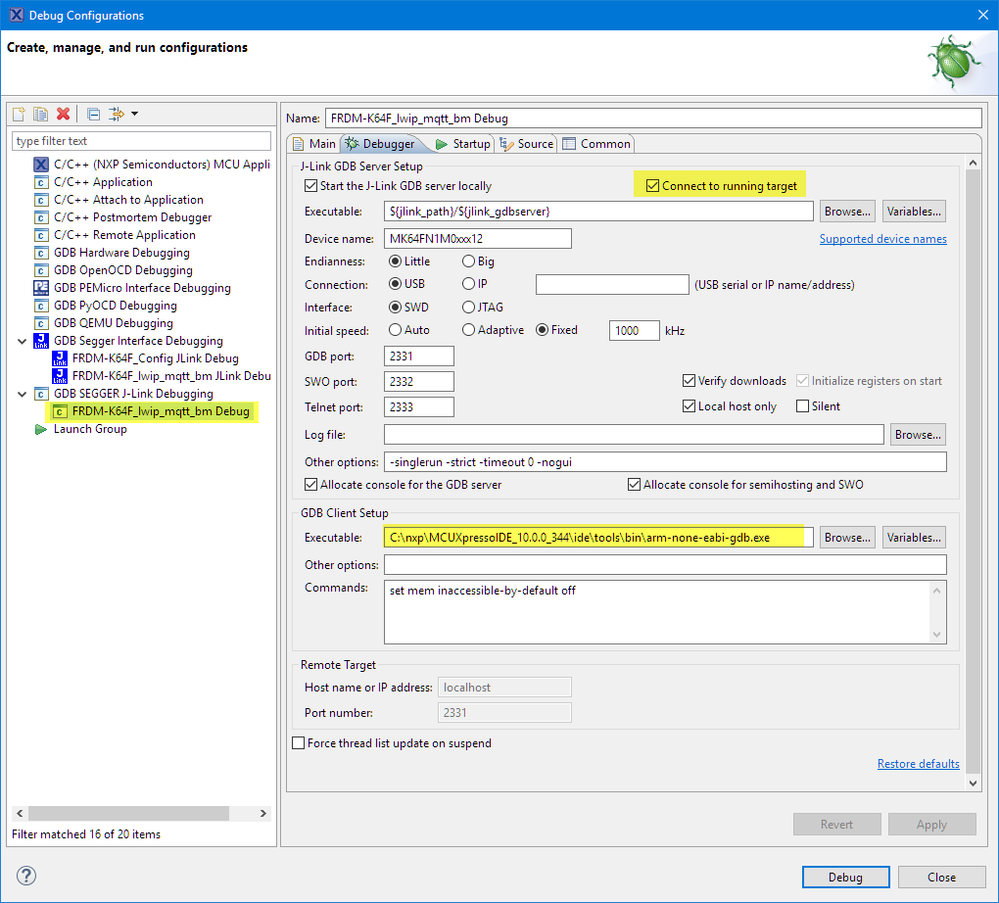

I am using a FRDM-k64 development board using the embedded j-link probe.  I'm having trouble figuring out how to attach the debugger to a running target.  There were a couple of threads I found that linked to possible solutions, but most of the links were dead.  I was hoping that there was going to be an option in the debug configuration settings that disabled reloading the code and resetting the processor but I'm not seeing it.  Is there somewhere else I should be looking?  Any guidance would be greatly appreciated, thanks.

Just a note to say that 'attach to a running target' will be supported for Segger debug connections in the next release of MCUXpresso IDE, expected later this year.
In the current version 10.0.0 'attach' is only available for LinkServer and P&E debug connections, so changing the OpenSDA debug firmware would be another option.
Within the IDE;  Help -> Additional resources -> OpenSDA Firmware updates, will take you to a site where you can select alternative OpenSDA firmware. I believe the default for the FRDM-K64 board is CMSIS-DAP (LinkServer) firmware so perhaps you have already changed to J-Link.

BlackNight
Hi Dave,
You can look here: Attaching to a Running Target with Segger J-Link, GDB and Eclipse | MCU on Eclipse
This is the process I'm using for MCUXpresso IDE too.
For this you have to install the GNU ARM Eclipse plugins into MCUXpresso (this will allow you as well to re-use KDS projects): MCUXpresso IDE: Importing Kinetis Design Studio Projects | MCU on Eclipse
Then use a debug configuration like this, pointing to your ARM GDB execuable (unless you want to use variables for it):
