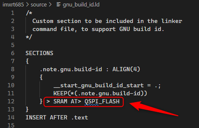

We are using MCUXpresso's Managed Linker Script feature.  However, we do have a small linker script to support gnu_build_id, used by Memfault.
The highlighted region is causing these warnings:
gnu_build_id.ld:12: warning: memory region `QSPI_FLASH' not declared
gnu_build_id.ld:12: warning: memory region `SRAM' not declared
imxrt685_Debug_memory.ld:15: warning: redeclaration of memory region `QSPI_FLASH'
imxrt685_Debug_memory.ld:16: warning: redeclaration of memory region `SRAM'
The MEMORY defined in the generated imxrt685_Debug_memory.ld is pretty typical.
Removing the highlighted portion from gnu_build_id.ld results in the warnings going away, but then the ID code may not appear at the correct address.
Perhaps something needs to be done with the the Miscellaneous or Managed Linker Script settings?

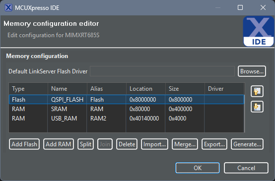

pcpro1789
@diego_charles QSPI_FLASH and SRAM are already defined in the MCUXpresso Memory configuration.

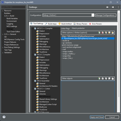

pcpro1789
@diego_charles The Managed Linker Script utility does indeed generate the memory.ld and library.ld files.
The custom script is integrated via the Miscellaneous linker settings (third screen capture in my original post).  Here it is again.  Please see the highlighted blue line.
