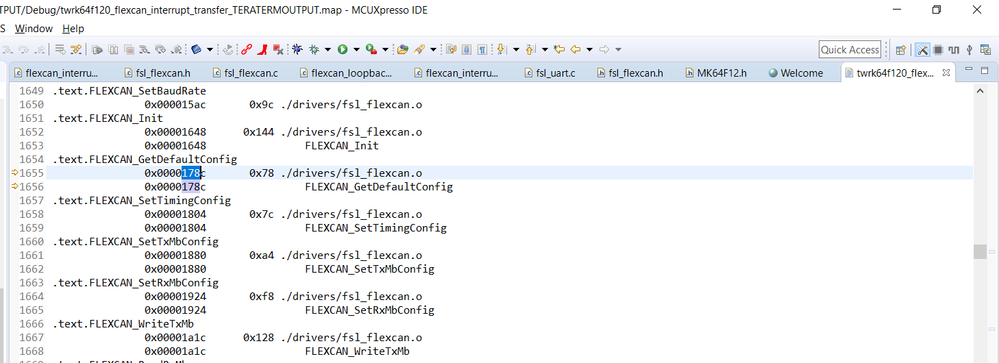

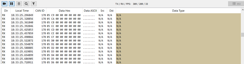

Now I am facing issue in the TxIdentifier [mailbox] .  The frame holds id and data in flexcan. The destination CAN ID to which I had to send the data is 1002F801(Hex value).
So I mapped 1002F801(Hex value) to my frame.id parameter(like frame.id = 0x1002F801 ) in flexcan code , its not sending the frame like how i expect.
I used an external SLCAN adapter to visualize it . I could see the CAN ID as 178 and 05 C9 is my value which i am sending.
I checked MCU xpresso code and I could find this
Few puzzling things are:
1.frame.id = 0x1002F801 is good enough to map the destination frame id? Or any work around is needed over here? Not sure how.
2. With respect to Tx, does TxIdentifier can be different from frame id? Because in the example code I could see frame.id being derived from TxIdentifer(29 bit identifier mask) [I also have a 29 bit identifier in my case in both sides].
Whereas, I know the destination id [1002F801] to which I need to send the data. Any simple approach is possible?
Any pointers would be helpful.

   Please ignore the above post. I got it figured. It was an issue with base and extended frame formats.
