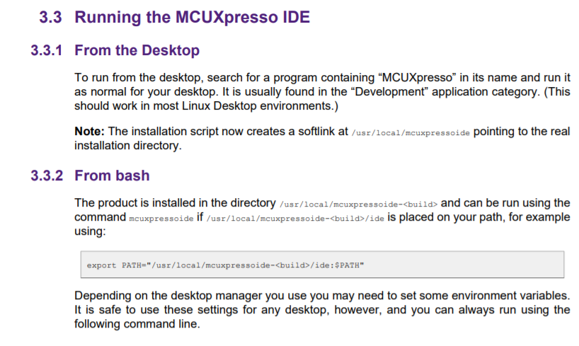

Hi Phirun:
Thanks for your sharing. You can refer to MCUXpresso IDE installation guider for how to lauch MCUXpresso IDE.
