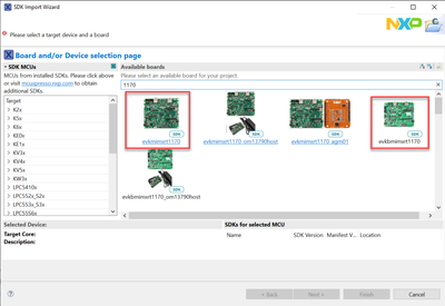

I'm implementing bootloader for MIMXRT1171 board, while importing SDK, I couldn't see an SDK with built-in  examples. But the same was there for MIMXRT1170-EVKB board.
Please provide the link for this MIMXRT1171 board to download SDK with built-in examples.

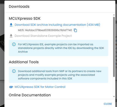

In the above image , SDK standalone example project is disabled. what may be the reason?
Please provide your suggestion.

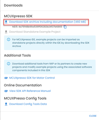

The example projects can be imported as standalone projects by downloading the SDK Archive.
After adding the SDK into MCUXpresso IDE you should be able to import the SDK example as following.
