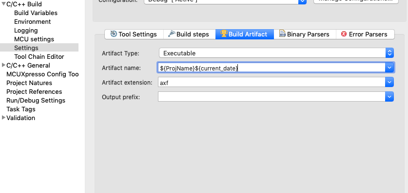

First, I would suggest using a different build configuration for each of your different builds. You then end up with each built file in its own directory.
If this is not what you want, you can use 'Build Variables'. You can see all of the build variable available to a project by looking in the project settings and clicking on the Build Variables section (and making sure the 'Show System Variables' box is checked. See below
To change the output file name (the build artifact), click on the Build artifact and change the Artifact name. For example to add the date to the name, use ${ProjName}${current_date}:
Good luck
