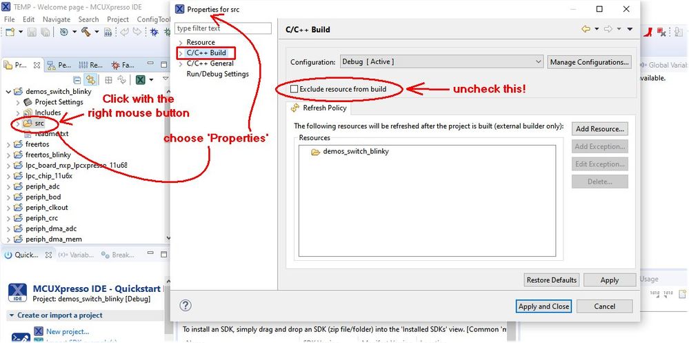

danielribeiro
Hi, Jefferson!
9,903 Views
jeffthompson
Contributor V
Thanks, Daniel, I did look at that early on and the new files were not excluded from the build. Since I re-cloned the project, it has been building with no problem, so I'm thinking something related to links and virtual folders didn't work right, or somehow got corrupted.
