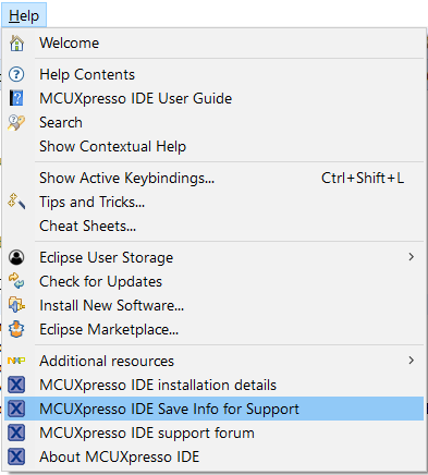

Maybe the information from the workspace log has some useful information for tracking down the issue. Would you please attach that information? You can easily obtain it using Help => MCUXpresso Save Info for Support.

msaliharslan
Sorry for the late response. I normally use the trackpad of my laptop, so I had to wait until I tried this with an external mouse since I cannot click longer periods of time with trackpad. With external mouse right click works normally, but the trackpad is still problematic. So, my previous comment claiming that the problem is related with the stating of the IDE turns out to be wrong since right clicking works with external mouse, but not with trackpad. Also, I was able to observe the behavior you described. Moreover, if file or folder is selected, it requires less time pressing mouse button than with not selected files or folders.
Lastly, I added the information you asked for.
