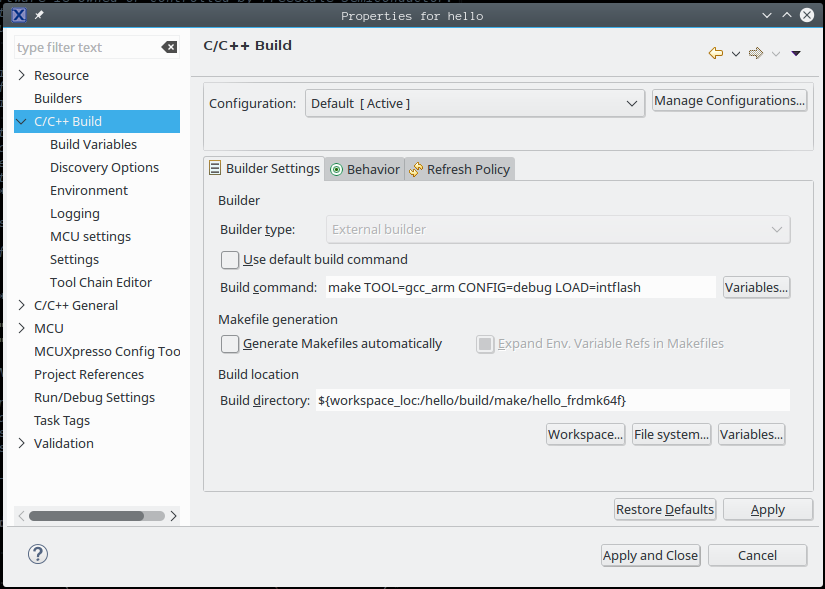

3. Create a new C project in eclipse with file>New>Makefile Project with existing code using the code found in MQX_4_1_1_LINUX_GA/mqx/examples/hello and name it "hello":
4. Once the project is created do a right-click>Properties and go to the C/C++ Build section. There, in the "Builder Settings" tab put the following:
Build command: TOOL=gcc_arm CONFIG=debug LOAD=intflash
Build directory: ${workspace_loc:/hello/build/make/hello_frdmk64f}

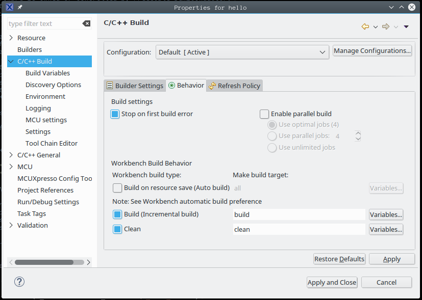

5. Now in the Behavior tab put "build" instead of "all" for the Build (Incremental build).
That's the only change in this tab

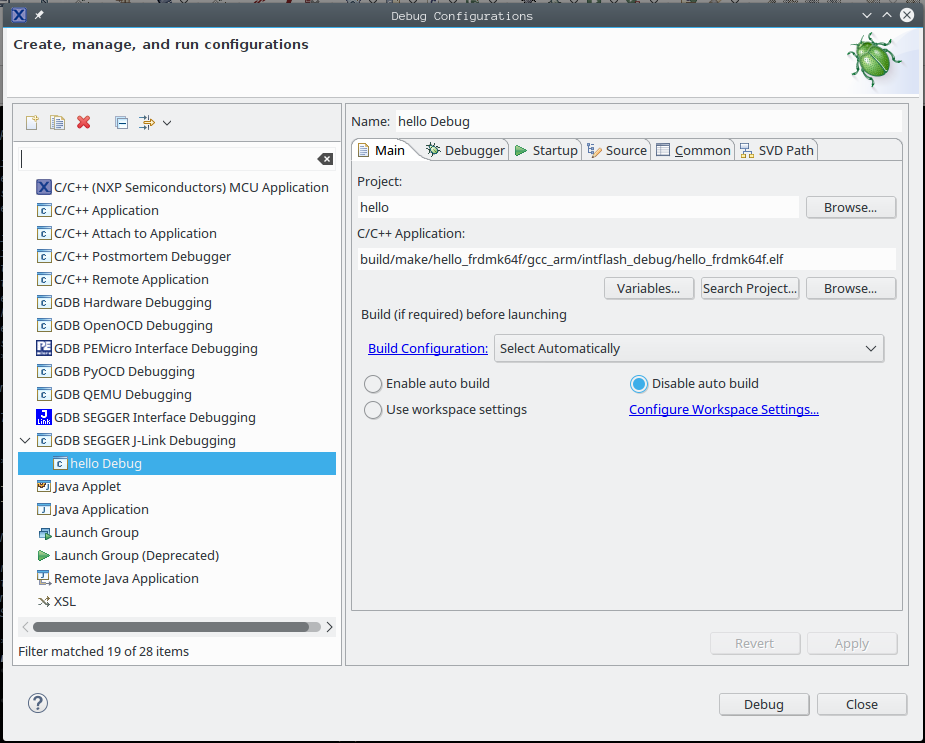

7. Create a new build configuration:
C/C++ Application: build/make/hello_frdmk64f/gcc_arm/intflash_debug/hello_frdmk64f.elf
8. Debug
