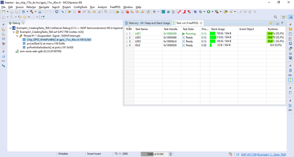

I am testing FreeRTOS on an LPCXpresso board:
  • Board: LPCXpresso LPC1769 (rev. C)
  • IDE: MCUXpresso 11.2.1 [Build 4149] (2020-10-07)
  • Library: LPCOpen v2.10 [2014-12-03]
  • Operating system: FreeRTOS 10.4.1
I have followed the prompts for "MCUXpresso IDE FreeRTOS Debug Guide" (Rev. 11.2.0 - 7 October, 2020) from NXP:
  • I have copied the header file "freertos_tasks_c_additions.h" from <install dir> / ide / Examples / Misc to the same folder as "FreeRTOSConfig.h".
  • The file "tasks.c" already comes with the code that includes the file "freertos_tasks_c_additions.h", so it is not necessary to modify it.
  • I have defined the following macros in FreeRTOSConfig.h:
    • #define configINCLUDE_FREERTOS_TASK_C_ADDITIONS_H 1
    • #define configUSE_TRACE_FACILITY 1
    • #define configRECORD_STACK_HIGH_ADDRESS 1
    • #define configGENERATE_RUN_TIME_STATS 1 (and I have also defined the macros portCONFIGURE_TIMER_FOR_RUN_TIME_STATS () and portGET_RUN_TIME_COUNTER_VALUE ())
  • And in the file "freertos_tasks_c_additions.h":
    • #define configFRTOS_MEMORY_SCHEME 1 (I'm using heap_1.c)
However, the FreeRTOS TAD task list appears empty and only the current task is displayed in the debug view.
I have been able to fix the task list thanks to https://mcuoneclipse.com/2017/03/18/better-freertos-debugging-in-eclipse/  By disabling the legacy API names in FreeRTOSConfig.h (#define configENABLE_BACKWARD_COMPATIBILITY 0) the task list fills up as if by magic. (I don't know if it is a very specific case, but it would be nice if it was indicated in the FreeRTOS Debug Guide; It would have saved me many hours of frustration).
But despite the fact that the project compiles, runs and works fine, despite the fact that the three tasks (plus the idle) that compose it are displayed in the FreeRTOS TAD task list (with their execution times), in the debug view only shows the current task, the one that was running when stopped.
I copy below the content of the debugging console, because I think the key may be there:

As you can see I am debugging in All-Stop mode. However, I don't get the message "FreeRTOS stack backtrace is enabled". Following the instructions of the FreeRTOS Debug Guide I have added a folder called "linkscripts" to the root directory of the project and I have created a file "user.ldt" with the content:
<#assign force_freertos = true>
It seems that something has improved, as it now mentions FreeRTOS, but it is not the expected result:
GDB nonstop mode disabled (using allstop mode)
FreeRTOS stack backtrace is disabled
Why? Can somebody help me? I insist that the project compiles, runs and works correctly. Tasks are displayed in FreeRTOS TAD task list, execution times are consistent. I can successfully debug the project ... The only problem is that the debug view only shows the current task.
Thanks a lot.
