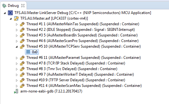

while using MCUXpresso, when pausing our application, the debug view shows 0x0 for a thread instead of a call stack. So the question is, what means 0x0?
Thanks for help, Sven

I think we have figured out the cause of the problem: It seems like as soon as we use any floating point operations in our code, and a FreeRTOS task switch occurs thereafter, then the call stack of the thread which used the FPU shows 0x0.
Therefore we checked the FreeRTOS task switching code, and realized that additional registers are stored onto the stack when the FPU was used (port.c => xPortPendSVHandler):
    "    tst r14, #0x10                        \n" /* Is the task using the FPU context?  If so, push high vfp registers. */
    "    it eq                                \n"
    "    vstmdbeq r0!, {s16-s31}                \n"
Could this be the reason that MCUXpresso cannot unwind the stack, when paused after a task switch?

I paused twice. The first time one could see the stack traces, as per usual. Then some time later (ca. 30s), the AUMasterTCPServ Thread showed 0x0 again. In the GDB-Console, one can see the following line:
205,896 85^done,threads=[{id="6",target-id="Thread 10",details="AUMasterTCPServ Suspended",frame={level="0",addr="0x00000000",func="??",args=[]},state="stopped"}]
This seems to be the place where it is broken.
I am not sure how the stack unwinding is done, but could it be that some memory leak has caused this problem? The strange thing is, that even though this thread cannot be displayed, when execution is continued, everything seems to be "fine".
We do however, under much more complex circumstances, have the problem that this particular thread deadlocks. This is how we realized that we could not see what this thread is doing in the first place.

I have attached a screenshot and the debug text when debugging was still working:

The thread was running and it's possible to set a break point in the thread. The thread stops there and shows a call stack. The 0x0 only occurs when pressing pause.
