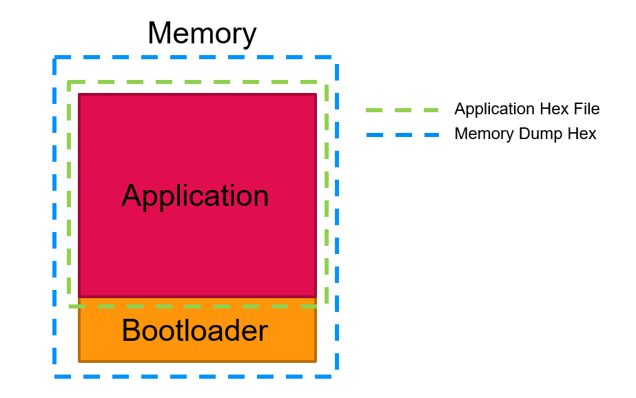

What can be done if the output read after flashing a hex file is not matching the flashed hex file in frdm KW36?

The hex file that I am flashing as mentioned in the document named ''Reprogramming a KW36 device using the OTAP Client Software" is ''frdmkw36_wireless_examples_bluetooth_glucose_s_freertos.'' Exporting the memory after flashing this hex file, the contents of memory after exporting and the hex file flashed do not match when compared.using Beyond Compare.

estephania_mart
Are you considering the bootloader space when you do the memory dump?
Please remember that a special bootloader was flashed and the application that you build separated has an offset, so if you are comparing the complete memory with just the application file it won't match.

estephania_mart
Yes, I understand that it's the process you are following, but you mention that the hex files do not match between the application you are flashing and the memory dump.
When you are comparing the hex files are you considering the diagram I'm attaching? Or are you just comparing the hex file from the offset that you add to the application when you compile it?

akshita_manwati
Hello
I am comparing the hex file from the offset that I have added to the application.

akshita_manwati
Hello
The issue was resolved, my hex file memory was larger than the size required. Therefore by flashing the correct hex file now my memory is matching.
