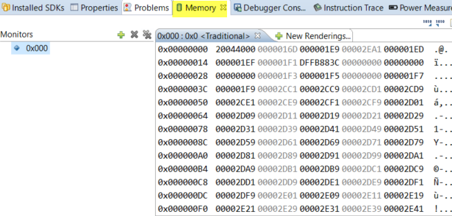

Hello Akshita Manwati,
Could you please describe your question detail.
How to flash hex file ? How to read ? What about the data in hex file and result of read?
You can also have a look at the flashed data in "Memory " view, check whether correctly flashed:

Hi Akshita Manwati,
How about compare the hex file with memory view I mentioned above ?

akshita_manwati
Hi Alice
On comparing with memory view some data don't match. Is it be possible due to run time changes?

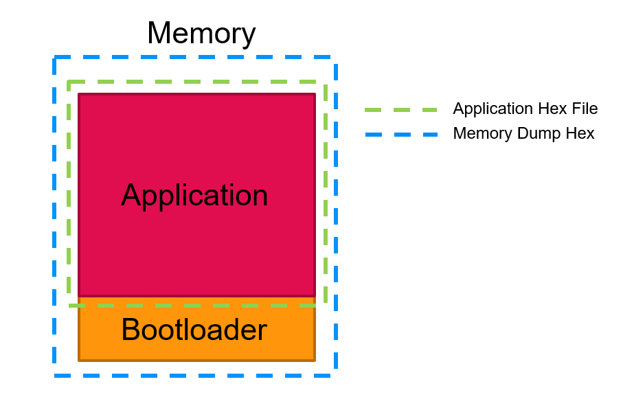

stephanie_m
Are you considering the bootloader space when you do the memory dump?
Please remember that a special bootloader was flashed and the application that you build separated has an offset, so if you are comparing the complete memory with just the application file it won't match.

stephanie_m
Yes, I understand that it's the process you are following, but you mention that the hex files do not match between the application you are flashing and the memory dump.
When you are comparing the hex files are you considering the diagram I'm attaching? Or are you just comparing the hex file from the offset that you add to the application when you compile it?

akshita_manwati
Hello
I am comparing the hex file from the offset that I have added to the application.
