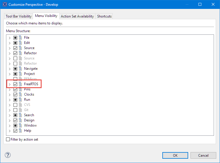

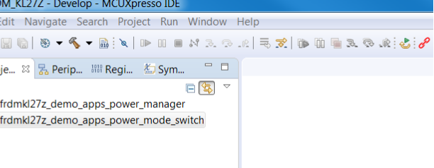

Hi I am using MCUXpresso IDE 10.0.2 and 10.1.1 . I made a fresh installation of both IDE . But I cannot find the FreeRTOS menu . Before this , I do have the FreeRTOS but now , no matter how many times I uninstall and install again , I still cannot get the FreeRTOS windows tab . Please help .
1,549 Views
BlackNight
Can you check it is turned on for your perspective (menu Window > Perspective > Customize Perspective....
I hope this helps,
Erich
