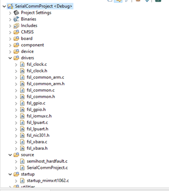

NVazquez
I tried to debug in ResetISR, looks like I don't go in ResetISR as well.

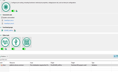

Does it has anything to do with this error,
Issue: Pins initialization requires the COMMON Driver in the project.
Level: Error
Type: Validation
Tool: Toolchain/IDE project
Origin: Pins:BOARD_InitPins
Target: Toolchain/IDE project: core0
Resource: platform.drivers.common
I installed the common drivers,
not sure what I am missing, or how can I debug at least.

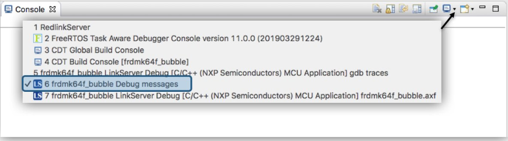

Can you help me showing me the debug log messages?
To display this log, select the Console and then click to view the various options (as below).
The debug log displays a large amount of information that can be useful in tracking down issues.
Does the same error appear when you debug an SDK example?
Please let me know your findings.

The content of debug messages is the following (from MCUXpresso 10.3.1):
