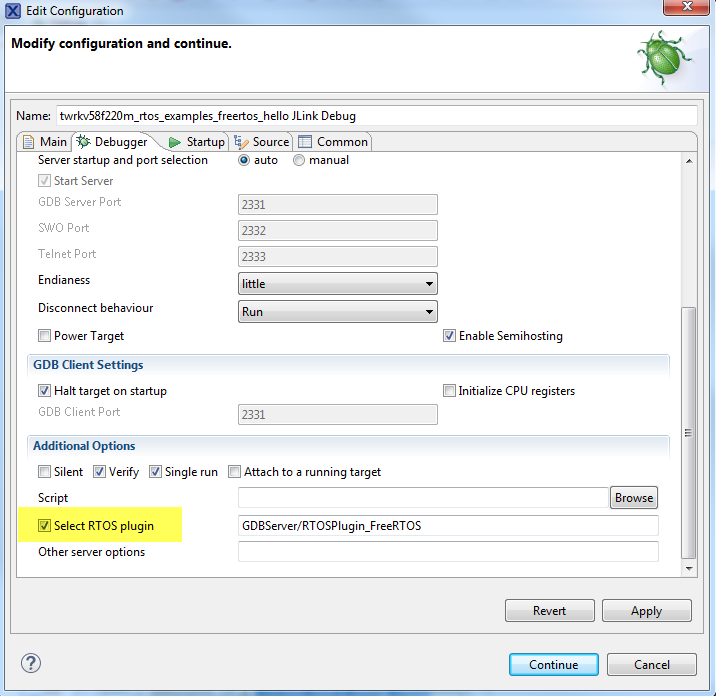

Hello ,
MCUXpressso IDE v10.1.0
Kinetis
Jlink debug

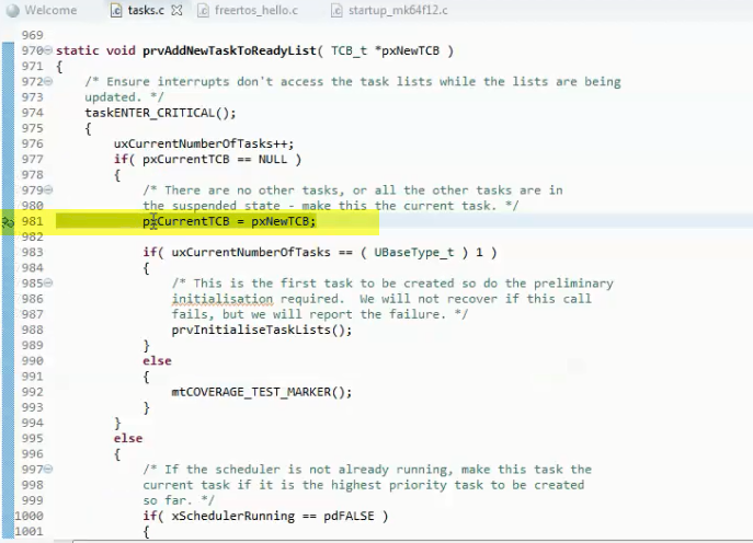

When enable  "Select RTOS plugin", debug a FreeRTOS demo under SDK,
it crash  when run the code "pxCurrentTCB = pxNewTCB; "in line 981 of tasks.c file ,
Thank you very much!

3. I just find that, after crash, continue run ,it seems it can work .
And if didn't set breakpoint on lin 981     pxCurrentTCB = pxNewTCB; , it also can work well.

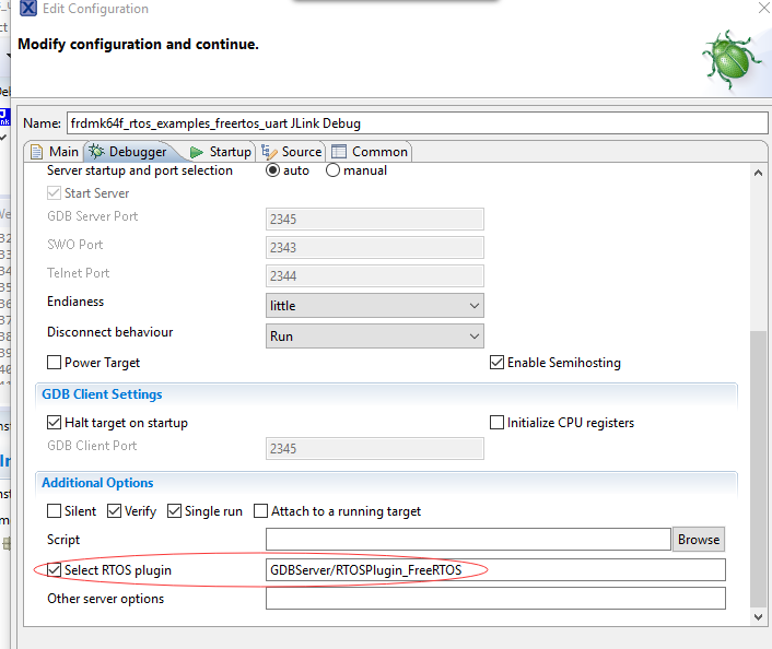

Hello Erich,
I have the same error on my side.
Win10 /win7
MCUXpresso IDE v10.1.1_606 /MCUXpresso IDE v10.1.0
FRDM-K64 board
I test the below three demos of SDK_2.x_FRDM-K64 , all the same.
Happening   this error once enable "Select RTOS plugin"
I take a vedio about it ,please have a look at my attachment .
Thanks very much!

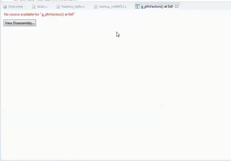

converse
Senior Contributor V
You get that error because your PC is now 0x0. Look in you registers view and the stack to see what's gone wrong with your program.
