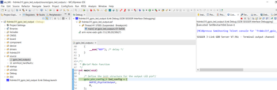

We are using kv31 evaluation board when i program flash retry to connect or abort notification showing.
bellow attached the screenshot if any additional power enabled or any other configuration  missing you have to guide me

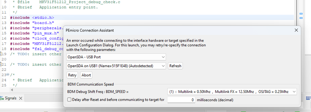

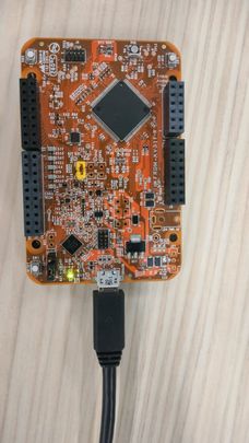

Hello, may name is Pavel and I will be supporting your case, could you share an image of your environment, about your connections.
The issue is presenting when the debugger does not find the power on the board, could you review you SWD or what kind of debugger are you using the debugger on the board or an external?

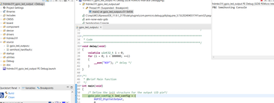

We are using MKV31F512VLL12 evaluation board in onboard debugger when i try to flash the code without any other connections  it is showing connect or abort notification as displayed  in the figure.

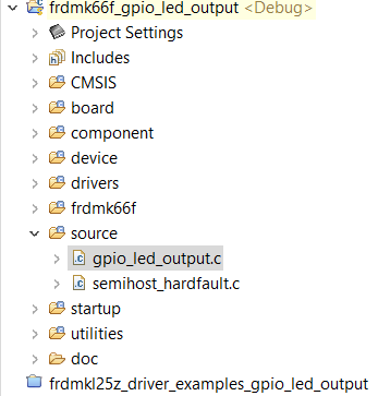

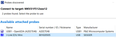

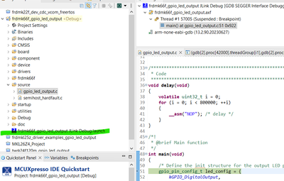

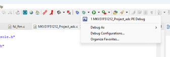

Pavel_Hernandez

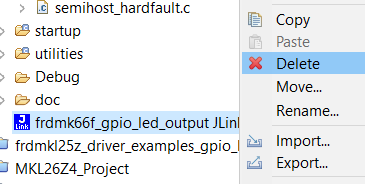

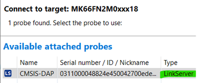

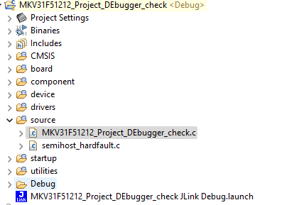

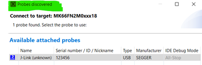

Hello, let me show you something, when you have a project without a debug launcher seems like this.
When a debug session is started, a popup window appears with all sondes available.
In this case the board has a J-Link firmware.
If I change for an external debugger or debugger firmware, I need to remove de launcher in order to the IDE stared again the Probe Discovery.
I change the OpenSDA from J-Link to LinkServer, but I need to delete the launcher to change the interface between the IDE and debugger.
Let me know if you have more questions.
Pavel

pandi
@Pavel_Hernandez Thank you for your reply.
We tried download the code as steps give by you, we also deleted the launch file but error not get resolved.

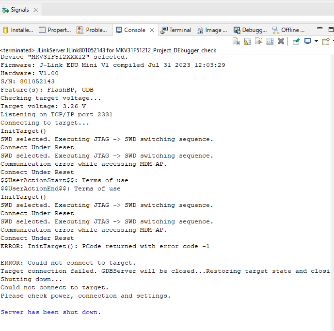

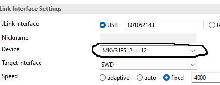

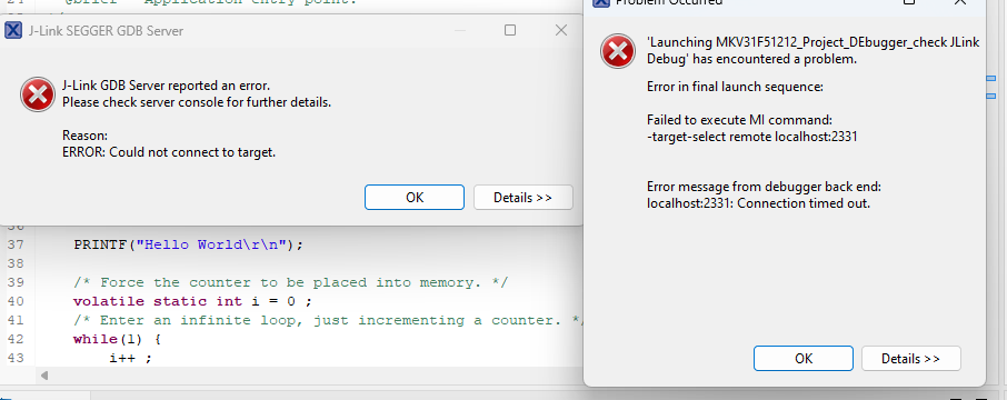

 Due to issue of onboard debugger Now we are using Segger mini EDU for downloading the code we are facing the different issue as mentioned below Screenshot 2024-05-07 123456.pngScreenshot 2024-05-07 123456.pngScreenshot 2024-05-07 123804.pngScreenshot 2024-05-07 123804.png
lWhatsApp Image 2024-05-07 at 12.50.28 PM.jpegWhatsApp Image 2024-05-07 at 12.50.28 PM.jpegScreenshot 2024-05-07 123512.pngScreenshot 2024-05-07 123512.png
with segger also we are  unable to download the code,we are facing the error as mentioned in the image.

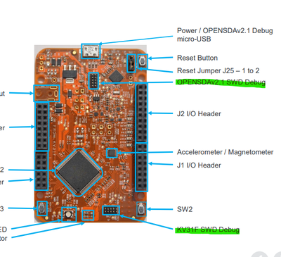

Pavel_Hernandez

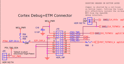

Hello, in order to use the external debugger in the board need to use it directly to the target.
The J24 is exclusive to communicate with the MK20 (the debugger).
To communicate directly to the MCU use this J19.
If the error still there, could you please do a mass erase?

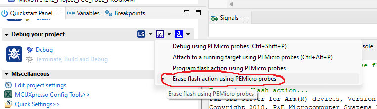

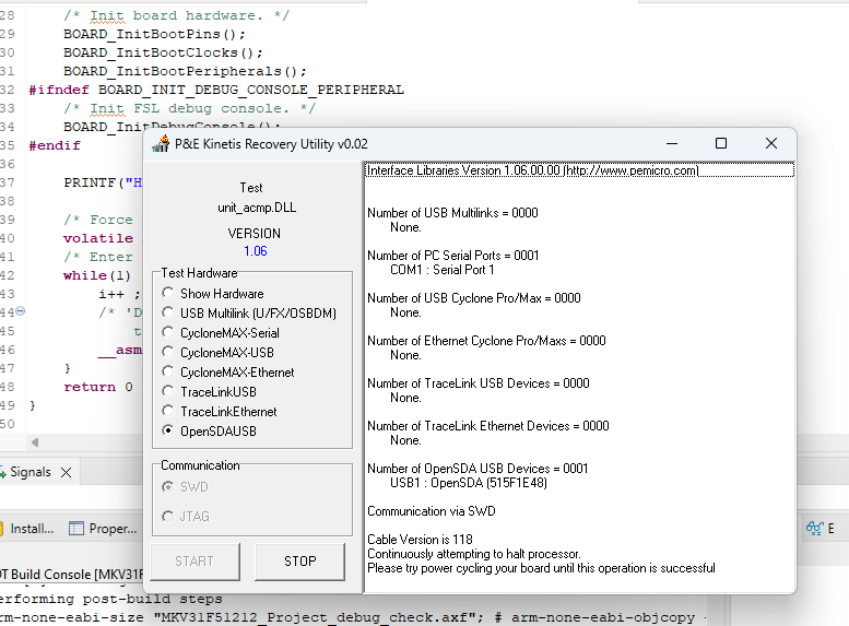

We are getting still facing below error and when I  erase the program , please tell me the procedure for mass erase.
This is correct or not if not means give correct method of erase the program.

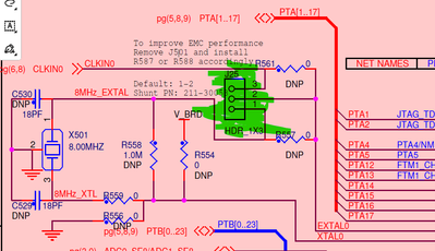

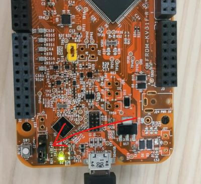

Pavel_Hernandez
Hello, yes that is a good way to do the mass erase, I saw something on your board.
Could you put the J25 in the default position?

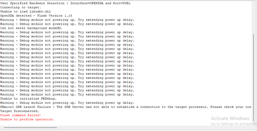

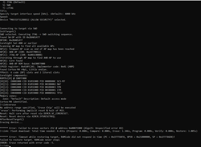

The Kv31 evaluation board has issues with the on-board debugger that we are using. When I flash the firmware inti target(); error displaying,
when using external debugger Segger J-link EDU mini is also not functioning. You mentioned that you were still having problems with the initial mass erase program, but when I tried for mass erase in the debug module, the terminal output indicated that it was not powering up.
Both Onboard debugger and with external debugger  Segger J-link  it detects IC  name MKV31F512VLL12  and also detects the debugger name .
From this we are unable to find where the error but still we can`t flash the code.

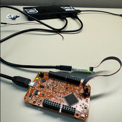

Pavel_Hernandez
Hello, I tested it on my side, and this works as expected with the recommendation that I mentioned. Are you sure that the board was working in the past?
I erased the MCU with the J-Link mini-EDU because this has the LED blinky demo.
Then I start a debug session with the J-Link external debugger.
Work as expected.
Then I tried with the debugger on the board has P&E firmware.
Pavel
