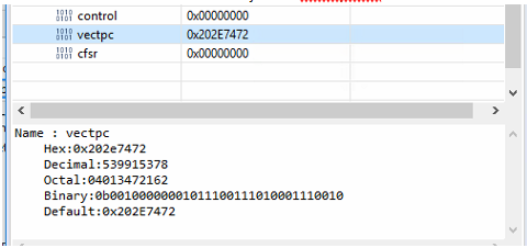

When experiencing a hardfault when debugging with LPCXpresso, looking at vectpc would give you useful hints on what had happened. Screenshot below is from a hardfault in LPCXpresso
In MCUXpresso this information does not apare:
How do I find the same information in MCUXpresso?

We'll be implementing a fix for issue with the (LinkServer-specific) "vectpc" functionality in the next IDE release.
In the meantime, and also if you try using a different probe type, then this blog article may be of interest...
Debugging ARM Cortex-M Hard Faults with GDB Custom Command | MCU on Eclipse
Basically this mimics exactly what the IDE is doing with "vectpc".

Thank you for the report - you appear to be correct.  We'll investigate.
