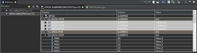

Hi @TomWilson ,
Yes, I have it that way:
I have documented all the settings I have changed in
Tweaking MCUXpresso IDE Black Theme | MCU on Eclipse
I hope this helps,
Erich

Hi @TomWilson ,
I hope this helps,
Erich

@ErichStyger, extremely helpful guide to IDE colour customization. Thank you!!!
