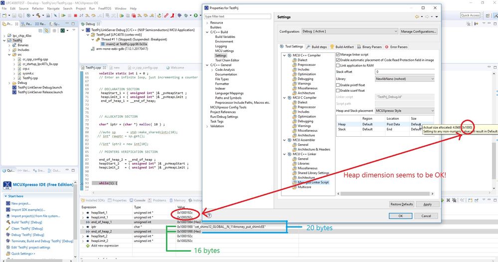

dimaios
So what you say makes little sense, certainly if you are using MCUXpresso IDE
I agree with you but the sample code works after the complete cleaning of all IDEs/drivers and fresh installation of the last MCUXpresso.
The project I've attached seems to work after IDE re-installation ( __end_of_heap changes according to the dynamic memory allocation ).
I cannot roll back the previous PC configuration but my colleagues have a similar problem so I'm looking for a configuration that shows the problem.
Here is a picture about the debug on my PC.

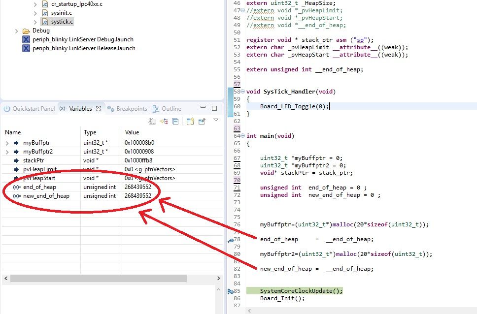

dimaios
Thank you for your kind replay.
The variable you suggested has always the same value.
I don't know if the extern variables declaration is correct but the following code fragment shows that end_of_heap ( before malloc ) and new_end_of_heap ( after malloc ) have the same value.
register void * stack_ptr asm ("sp");extern char _pvHeapLimit __attribute__((weak));extern char _pvHeapStart __attribute__((weak));
extern char __end_of_heap __attribute__((weak));
    end_of_heap = (void* )& __end_of_heap;
    myBuffptr=(uint32_t*)malloc(20*sizeof(uint32_t));
    new_end_of_heap = (void* )&__end_of_heap;
What's wrong ?
Thanks in advance.
Best regards.

dimaios
I've changed the variable type according to your suggestion but the result is anyway wrong.
Before and after the check the __end_of_heap variable has the same value.
I don't understand why the __end_of_heap variable doesn't change according to the current heap pointer.
Any other suggestion ?

dimaios
Yes. The problem is that the __end_of_heap doesn't change after the memory allocation as expected.
