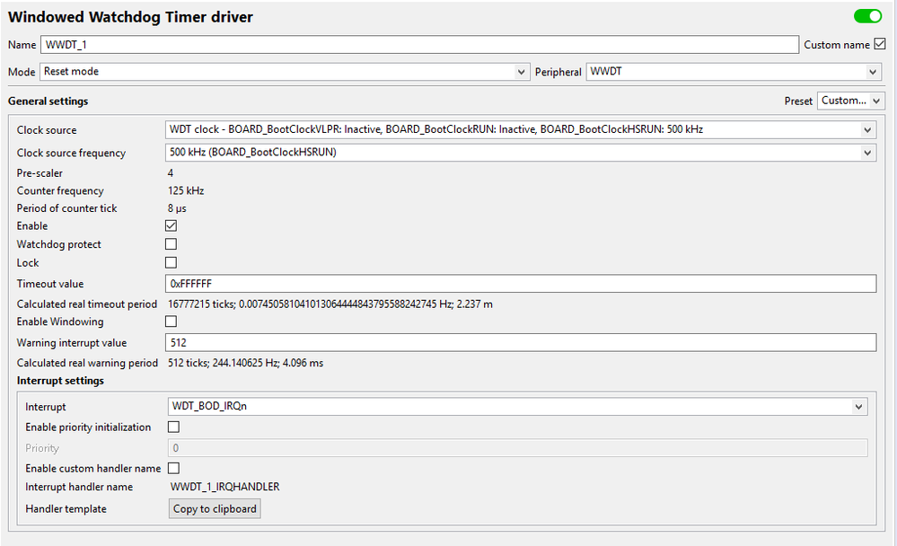

Hello everyone,
I am developing a project using the LCP54113 MCU wich requires watchdog.
I used the ConfigTools to facilitate the configuration, but there seems to be a problem. The code generated does not sets the frequency for the WWDT. The workaround I found was to manually set, by doing:
#define WDT_CLK_FREQ CLOCK_GetFreq(kCLOCK_WdtOsc)
WWDT_1_config.clockFreq_Hz = WDT_CLK_FREQ;
Of couse, this requires me to change the declaration of "WWDT_1_config" both on peripherals.c and peripherals.h file, removing the "const" declaration. This is pretty annoying, as long I have to do this every time there is any change on the chip configurations generated by ConfigTools. If i don't do this, the processor stalls on initialization, once "WWDT_1_config.clockFreq_Hz = 0".
Is there any known bugs related to this? Could be there any mistake from me?
The WWDT component configurations are:
The code generated for WWDT is:

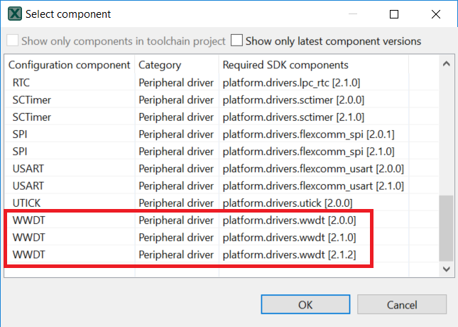

Lukas_Heczko
Hi Eduardo,
Can you please also specify version of MCUXpresso SDK you are using?
From the snippet you included I see that you are using WWDT Peripherals tool component version 2.0.0. This component is aligned with WWDT SDK driver version 2.0.0 (present in SDK v2.4.x or earlier) which in fact does not use clockFreq_Hz in the wwdt_config_t structure.
typedef struct _wwdt_config
  bool enableWwdt; /*!< Enables or disables WWDT */
  bool enableWatchdogReset; /*!< true: Watchdog timeout will cause a chip reset
  false: Watchdog timeout will not cause a chip reset */
  bool enableWatchdogProtect; /*!< true: Enable watchdog protect i.e timeout value can only be
  changed after counter is below warning & window values
  false: Disable watchdog protect; timeout value can be changed
  at any time */
  bool enableLockOscillator; /*!< true: Disabling or powering down the watchdog oscillator is prevented
  Once set, this bit can only be cleared by a reset
  false: Do not lock oscillator */
  uint32_t windowValue; /*!< Window value, set this to 0xFFFFFF if windowing is not in effect */
  uint32_t timeoutValue; /*!< Timeout value */
  uint32_t warningValue; /*!< Watchdog time counter value that will generate a
  warning interrupt. Set this to 0 for no warning */
} wwdt_config_t;‍‍‍‍‍‍‍‍‍‍‍‍‍‍‍‍‍
The clockFreq_Hz was introduced into wwdt_config_t in WWDT driver from version 2.1.0 (SDK v2.5.x and later).
So I guess you are combining the WWDT component with incorrect SDK version. You can pick the proper version of WWDT component in the component selector when adding component to the project (be aware that you first need to remove the previous version from the project):

eduardocarletti
Hi Lukas. That was exactly my mistake. My SDK was updated, but I did choose the older version of the component. Its working now!
Thank you!
