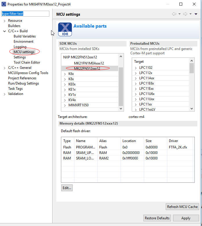

- Change MCU at "MCU setting" :

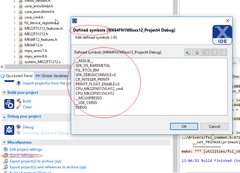

- Change "Defined symbols" refer to k22 project setting :

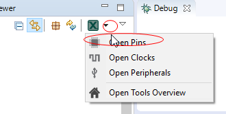

-  Open pins config :

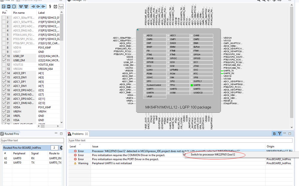

there will be some error , right click the error message , refer to reminder to do :

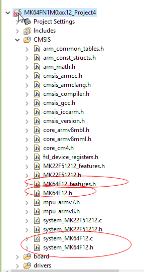

You also need to replace or edit CMSIS/fsl_device_registers.h as it references the <processor>.h and <processor>_features.h files. Otherwise, everything worked perfectly.
