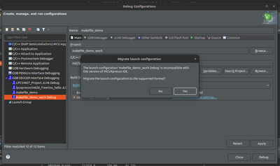

I am having a problem creating a new GDB SEGGER Interface Debugging configuration. Whenever I try to create a new one I get prompted with the message:
The launch configuration 'project_name' is incompatible with this version of MCUXpresso IDE.
Migrate the launch configuration the the supported format?
If you hit yes it lets you fill out the different available fields, but once you hit "Debug" to start your session you are hit with the same message again, and prompted to delete the invalid configuration and start over, thus getting stuck in an unending loop where no progress is made.

If I modify that generated configuration to work with my makefile based project and copy it to the project, after launching it I get the following error:
I also tried making an empty project from the SDK targetting my desired processor and could download it and debug it into my custom board. I decided to try and edit that configuration to use it on my project but that one also got the error above once I got to actually trying it out.
If I hit the blue debug button to generate a configuration on my makefile project (the one I'm actually trying to debug), after I get prompted to select a connected probe, nothing happens. I know this is not working right because if I do the exact same process with a project created from the SDK I can actually generate a debug configuration using that button.
If I got through the green button and try to generate a new configuration from scratch, I get the following:
This happens just after double clicking the GDB SEGGER Interface Debugging option on the left panel to create a new configuration. If you hit yes it lets you edit values but once you get to actually trying it out it goes into the loop I described in my initial post.

How are you generating the debug configuration? I suggest that you let the IDE create it (e.g. using the quickstart panel, or delete all .launch and start a debug session).
That error message you describe is something I would get if you create manually an incompatible debug session in the run/launch configuration dialog of Eclipse. If you do it there, make sure you create it under 'GDB SEGGER Interface Debugging':
This because the MCUXpresso IDE uses an extended debug configuration.
You can create other debug configurations too (as you see in my screenshot for 'GDB SEGGER J-Link Debugging' on the bottom, but then you have to use the 'green debug toolbar icon' and not the 'blue' on, or manually launch it. Because the IDE otherwise wants to launch its own configuration type.

Hey! Thanks for the reply, check my response to Alex on the thread for a more detailed explanation on what I'm doing.
The tl;dr is that yes I've tried what you are describing and I am not having much luck. I tend to use the green button on custom boards, but I am getting the error I described when I double click the option you mention to start creating a new configuration. It can't possible be an invalid configuration if I just essentially clicked "new". There seems to be an incompatibility with how my project is set up and what the ide expects. If I follow this same process in vanilla eclipse with the CDT tools I can generate a configuration and debug, but I'm having some trouble getting the session to not hang while debugging freertos and that's why I am trying the NXP tool again
