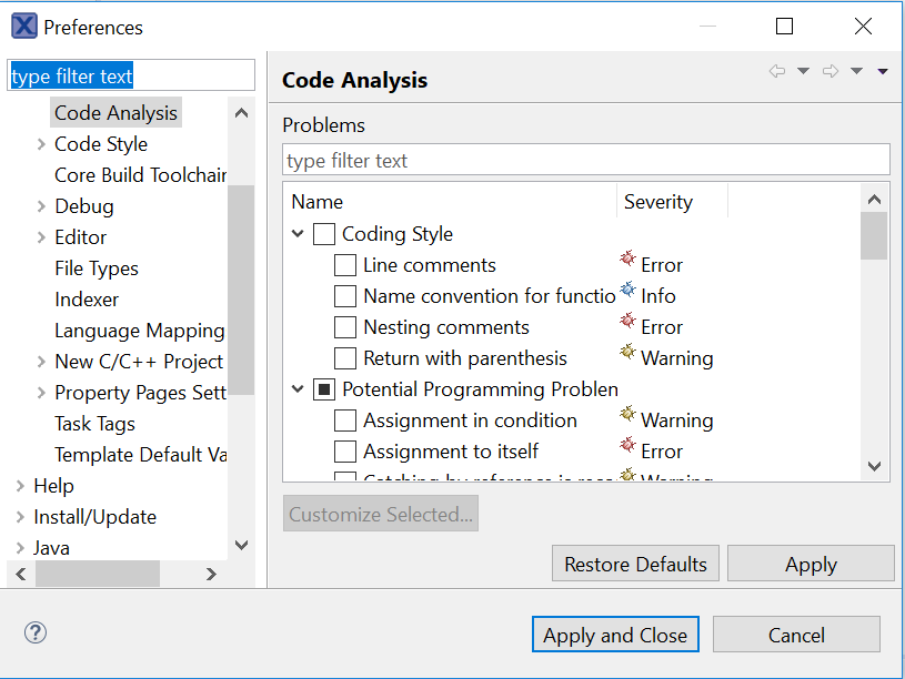

I just ran into this in MCUX 10.3.  If you go into the code analysis settings and disable problems and then hit 'apply' or 'apply and save', it discards your changes.  To get it to save, you have to also change something else about the entry, like its severity.

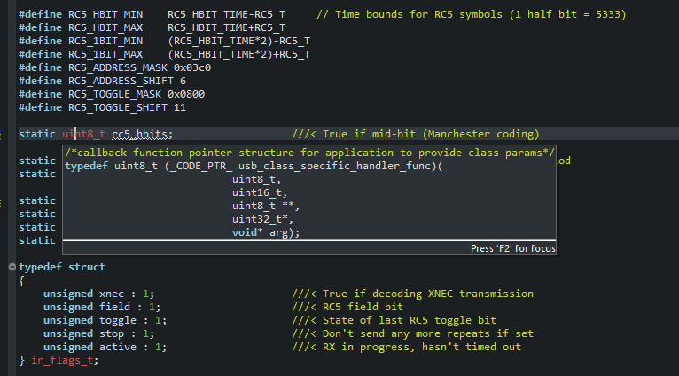

The reason I'm disabling a warning is that there seems to be another bug that I haven't noticed before.  For some reason, static variables with file scope are reported as unused function declarations, when they are neither unused nor functions declarations.

Do you mean Code Analysis option here? I tried disabling an error then apply and close. next time I see the the change take effect.
Is there any misunderstanding ? if yes, please send me screenshots/video of how to reproduce your issue. Thus I can check it further.

It started doing it again and this time I captured a video.  This video shows both the problem with the settings not saving, and static variables showing up as unused function declarations.
Regarding the code analysis problem itself, it looks like the problem is the code analyzer not handling typedefs for function pointers correctly.  If I mouse over the uint8_t type, I get this:
If I ctrl-click on uint8_t it takes me to stdint.h like you'd expect.  The definition it's finding is in the old USB stack v5, which is in a folder excluded from this build, and usb_class.h isn't even in the file's include hierarchy.

your 2019-04-05 20-24-36.mp4 is for your original problem, right? If yes,
- how it works if you create a new workspace to test the problem?
- how it works if you rebuild the project after you modifying the setting?
if the problem keep same for above two tests, I need reproduce them anyway, Which demo code you are working with ( link?)? you will test it.

I tested with a new workspace and the TWRK21F120M hello_world demo and it saved OK.  I switched back to my normal workspace and it saved at least the first time I tried it, and then I switched it from 'info' to 'warning' and tried again and it's back to not saving.
