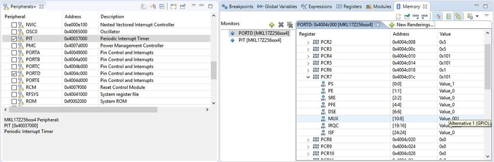

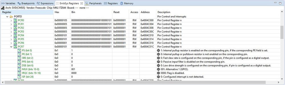

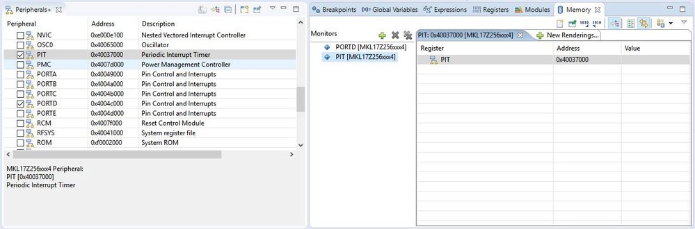

I have tried debugging an MKL17Z bare metal project and I'm struggling to find a good peripheral register view. In KDS, the EmbSys view showed all peripheral registers and translated the control register configuration. I found in MCUXpresso the Peripherals+ view shows the chips peripherals, but clicking only opens the peripherals memory address in the memory view. Not all of the peripheral registers are read in the memory view (e.g. SIM does not display any registers) and none of the control registers are translated. This was a big time saver. Does anyone know of an equivalent for MCUXpresso?

Thank you for the quick reply. I am using a J-Link on Win10. I have a break point in the PIT timer interrupt which triggers ~1msec. I don't do anything to disable the timer yet the registers are still not showing.
At the same time, the PORTD registers are showing just fine. Since posting I realized the register translations are available while hovering over the value.
This process of reading peripheral registers is convoluted compared to KDS (shown below). Even if it's only offered as an optional plugin, I would much prefer to have the EmbSys view available.

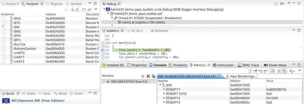

Seems to work OK here. Here is the view in my current K22 debug session - via an OpenSDA J-link probe...
One thing to remember is that the Peripheral Register view in the Memory View will only display content if the peripheral is powered/clocked. [There peripheral will appear in red with a hover message if this is the case.]
