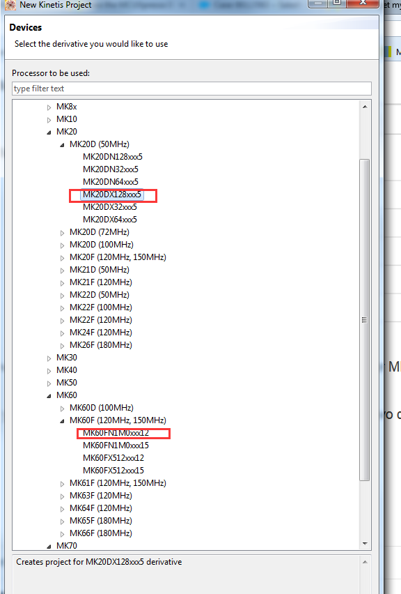

I am trying to work with MK60FN1M0VLQ12 and MK20DX128VMP5 at mcuxpresso however i cant find these processors to work with. Could i use other processor or the support for these are not available yet ?

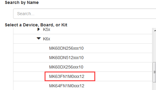

Dear Alice, thanks for the answer. The problem is that I cannot find
MK60FN1M0VLQ12 on the list of processors in order to generate the sdk.
There is only three k60 parts and none match this fpu 1m flash that I am
using in my project.
Can you investigate why it's not available the MK60FN1M0VLQ12 on MCUXpresso
sdk generator?

Hello Juliano,
Sorry for my mistake, I misunderstand the MK63FN1M0xxx12 to MK60FN1M0xxx12, sorry。
OK, I will also ask the MCUXXpresso SDK team about the support for MK60FN1M0xxx12 .

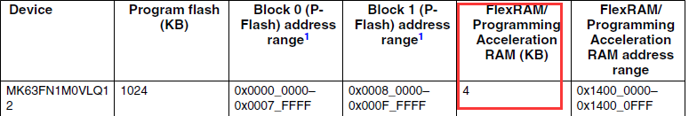

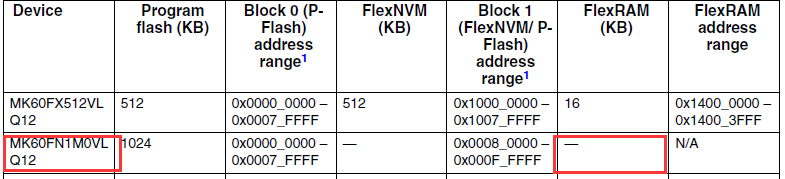

Hello Juliano,
I think its hard to use SDK for k63FN1M0xxx12 to K60FN1M0xxx12 .
For there are many difference between them , for example :
- The FlexRAM:
- The CAN interrupt vector number .
- K60 has 4 ADC , K60 only has 2 .
- k60 has PTA PTB PTC PTD PTE PTF , while K63 hasn't PTF port .
- And so on .
You can refer to the compare the manuals of the two chips, also you can create a simple project
on KDS, then compare the header fiels .
While if you only use the modules that they are the same , maybe you can use the SDK for k63 into k60 .
Alice
