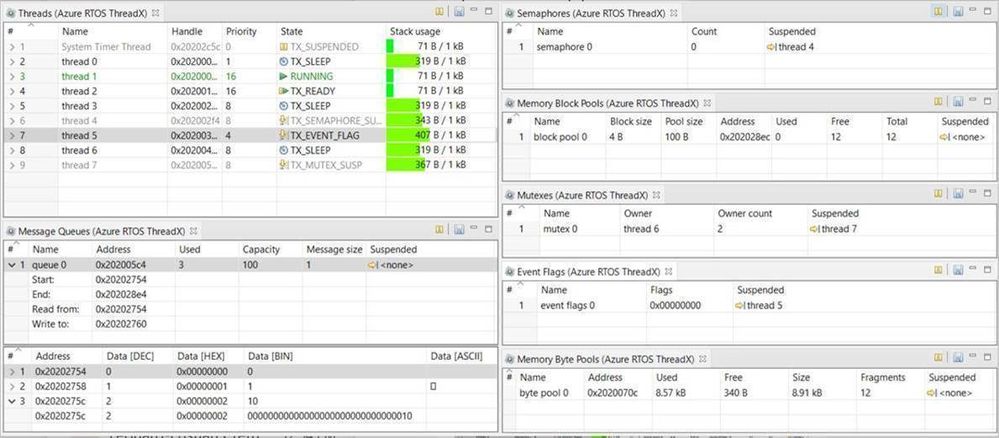

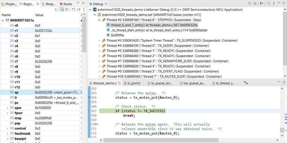

  • Feature: [Azure RTOS ThreadX] Added GDB thread awareness. The user is able to see threads in Debug view (only when using all-stop debug mode, similar to FreeRTOS usage) and also the register context associated with the current selected thread.
  • Feature: [Azure RTOS ThreadX] Added views, similar to the FreeRTOS, for: Thread list, Message queues, Semaphores, Mutexes, Event flags, Timers, Memory block pools, Memory byte pools. These views are available under a new menu group called "RTOS", where older FreeRTOS views can be also found.
  • Feature: [Azure RTOS ThreadX] Added the ability to export trace data generated by the application at run-time. Decoding of exported data is done using Microsoft's Azure RTOS TraceX host-based analysis tool. Detailed procedure is described in the Azure RTOS User Guide.

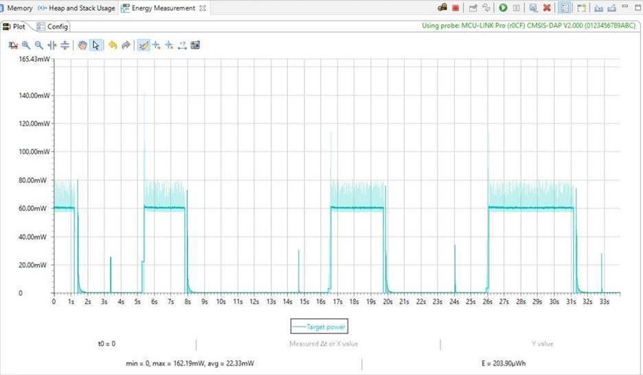

  • Feature: [Energy Measurement] Added measurement/plot capability for MCU-Link Pro and on-board probes. Power measurement can be done using:
    • The new MCU-Link double channel measurement capability (simultaneously measured current and voltage);
    • Existing capability (used over LPC-Link2 probes) of caching voltage measurement to use on power computation over current measurement.

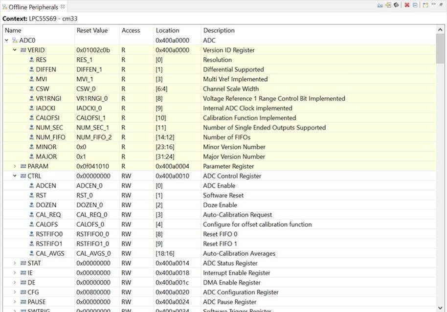

  • Feature: [Offline Peripherals] Added offline peripheral view. With this view, the peripheral registers can be inspected outside of a debug session. A device selector or the current project selection can be used to load register information for a particular device. Additionally, an SVD file can be imported.
