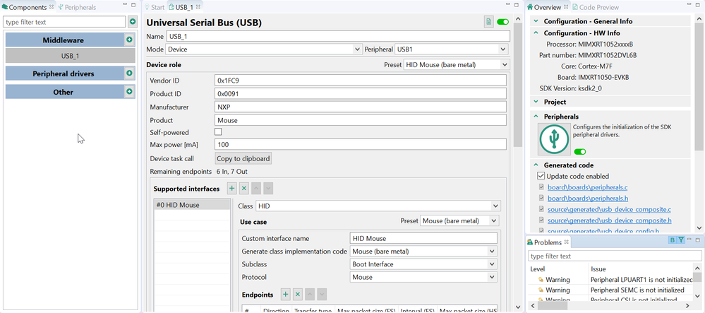

 i created a RT1050 project by using MCUxpresso,if i do not initialize Peripherals,I can compile the project.after i  initialized Peripherals by using the Peripherals Tool  ,i got "java.lang.NullPointerException "error while updating code. is anybody can help me.

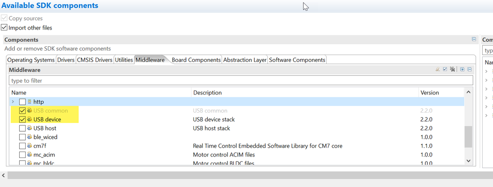

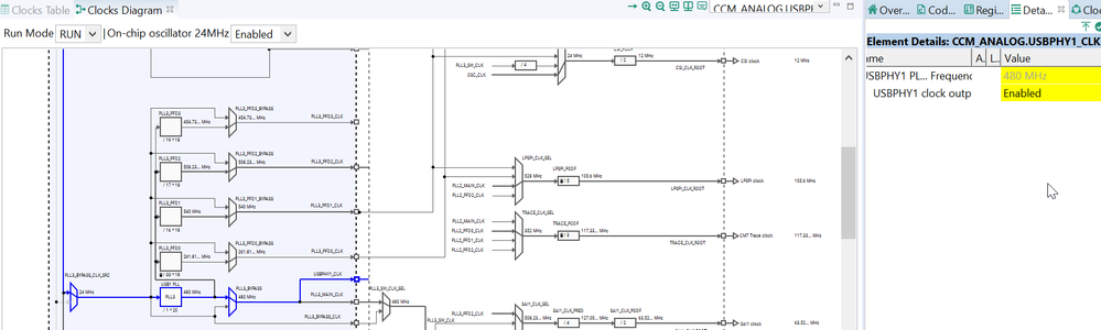

I tried to replicate your issue on my side but I could successfully compile the project after initialize peripheral using Peripherals Tool. Please check my steps below. I am using SDK 2.6.1
  • I created a new project.
  • Enable USB device component by going to SDK management.
  • Enable the USB peripheral using Peripherals Tool as follows.
  • Enabled the USBPHY1_CLK by using Clock Tool.
By doing this my project compiled correctly, could you please tell me if you are following the steps above on your side as well as the SDK version you are using?
