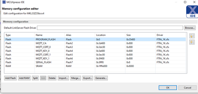

My call is:
extern uint32_t __base_MQTT_CERT_0;
main()
  MyFunc((uint8_t*)&__base_MQTT_CERT_0);
Linker file:
  __base_MQTT_CERT_0 = 0x3dc00  ; /* MQTT_CERT_0 */
MCUXpresso config:
So It is an address value given by the linjer file corresponding to a memory specific defined zone...
How can I resolve this warning?

ErichStyger
Specialist I
The problem is with 'FlashAddressPtr': you are passing the address of an object to your MyFunc with FlashAddressPtr which points to an object which is not large enough. So a classic 'array out-of-bounds' programming error.
You only get the warning with higher optimizations, because here the compiler does constant propagation and variable analysis cross function calls.
So I recommend you check all calls to MyFunc() and check if you have passed an object of adequate size passed.
To illustrate the case, consider following code:
static bool MyFunc(const uint8_t* FlashAddressPtr)
 // const uint8_t Header[] = {0xF1, 0xF1, 0x01, 0x00};  /* Magic Code + the number of Certificate file... */
  uint32_t      ListSize;
  uint16_t      ContentLen;
  memcpy(&ListSize, (FlashAddressPtr + 4) , 4);
  memcpy(&ContentLen, (FlashAddressPtr + 10) , 2);
  return false;
static const uint32_t var = 0x10;
int main(void) {
  (void)MyFunc((uint8_t *)&var);
Here you pass the address of an object to your function, which is not large enough for your (FlashAddressPtr + 10): your object has to be at least 10+2 bytes large.
I hope this helps?
