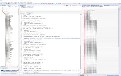

I have been getting the following linker error being posted by a host of .ld files that included in my workspace but not used by my project settings and I'm not sure how to have MCUXpresso ignore them.

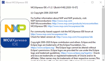

I am using version v11.2.1 of MCUXpresso:
I modified my project settings as per the following forum entry but this has made no effect on the ASSERT issue.
https://community.nxp.com/t5/MCUXpresso-IDE/How-can-we-disable-the-syntax-checking-of-linker-files/m...
This does not prevent my project from building and I am still able to load and debug my project with no issues.  It's just that I don't know why MCUXpresso is indicating that they are there
Does anyone have any other suggestions to follow?

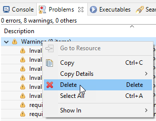

Otherwise: if you open the file with the text editor, the errors still remain in the Problems view.
To get them removed, go to the view and delete them:

attached is one of the linker files.
The interesting thing is that my project does not even use any of these .ld files, so all these error messages really confuse finding and fixing errors when they do happen.
The error message is associated with lines 117 and 154.
. = ASSERT((__data_load_start__ + SIZEOF(.data)) >= __FLASH_segment_start__ && (__data_load_start__ + SIZEOF(.data)) <= (__FLASH_segment_end__) , "error: .data is too large to fit in FLASH memory segment");
. = ASSERT(__heap_end__ >= __SRAM_segment_start__ && __heap_end__ <= (__SRAM_segment_end__) , "error: .heap is too large to fit in SRAM memory segment");

Hi @tbiberdorf ,
The IDE parses the file when you open it, flagging errors that time. The messages are not coming from the linker but from the IDE.
Looking closer to your ASSERTs I think they are indeed wrong, see https://sourceware.org/binutils/docs/ld/Miscellaneous-Commands.html : you cannot use them as expressions and assign it to the current location: you need to remove the .= in front of them.
