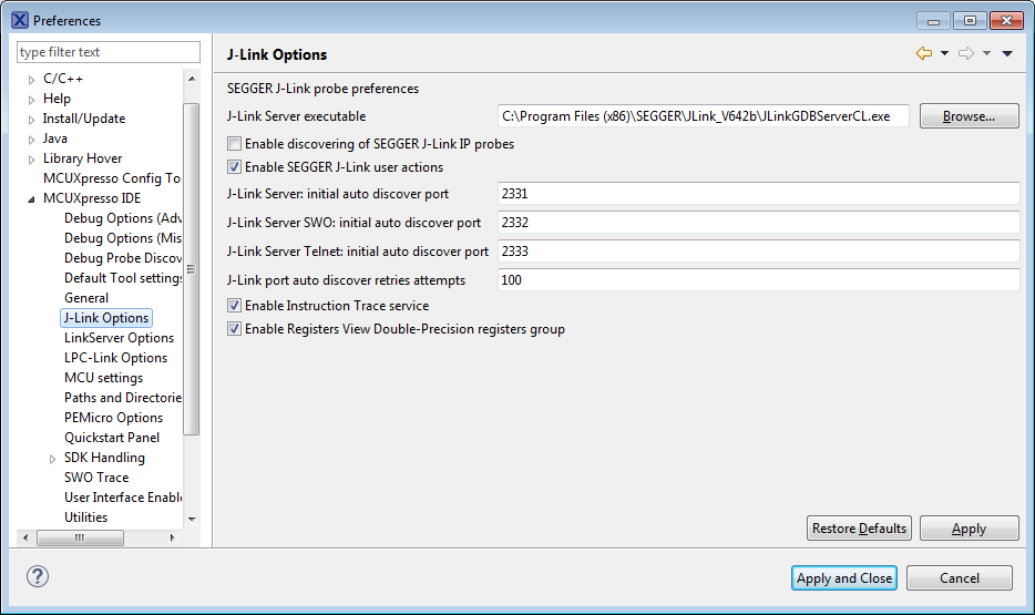

Where can I change the location of the Jlink executable in MCUXpresso?
I have installed a newer version of Segger Jlink driver, and I want MCUXpresso to use the newer version.
I have MCUXpresso 10.3.1
1,642 Views
danielchen
Hi  Nishanth:
  MCUXpresso IDE automatically locates teh required executable and it is remembered as a workspace preference. This can be viewed or edited with preference as below
