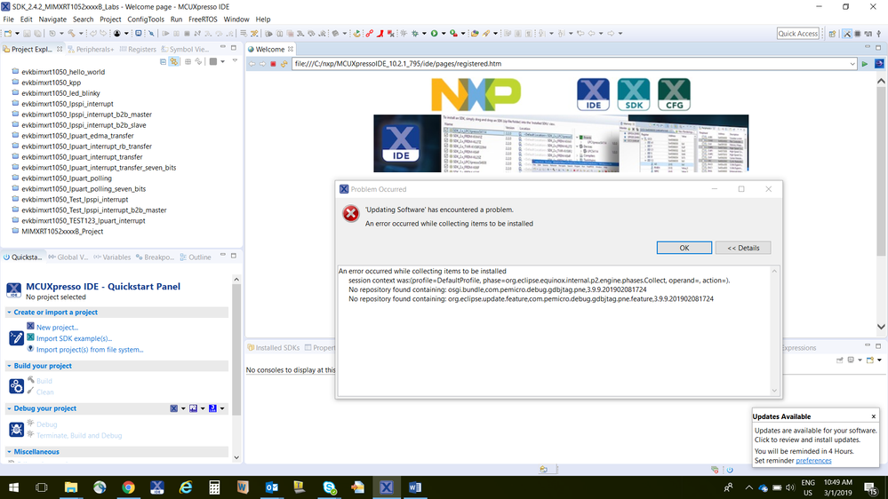

I am facing couple of tool issue.
Issue 1:               We could not update the config tool in offline mode.
Issue 2:               When we do “Install new software” please refer the attached document
Issue 3:                When we do “check for updates” please refer the attached document.

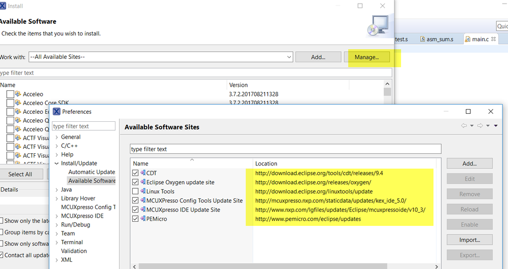

1. Issue 1: About update MCUxpresso Config Tool on IDE, it seems we can only use online mode.
2.Issue 2 and Issue3, please delete the update site which error remind :
use the websites below:
http://download.eclipse.org/tools/cdt/releases/9.4
http://download.eclipse.org/releases/oxygen/
http://mcuxpresso.nxp.com/staticdata/updates/kex_ide_5.0/
http://www.nxp.com/lgfiles/updates/Eclipse/mcuxpressoide/v10_3/
http://www.pemicro.com/eclipse/updates
Then check whether it can work well.

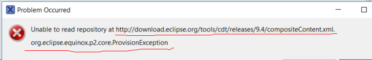

Hi Alice Yang,
Receiving the below error

Hello other customers,
Swaminathan sharing it can work well on MCUXpresso IDE v10.3, if any others meet the same problem,
please also try to use latest version, thanks.
