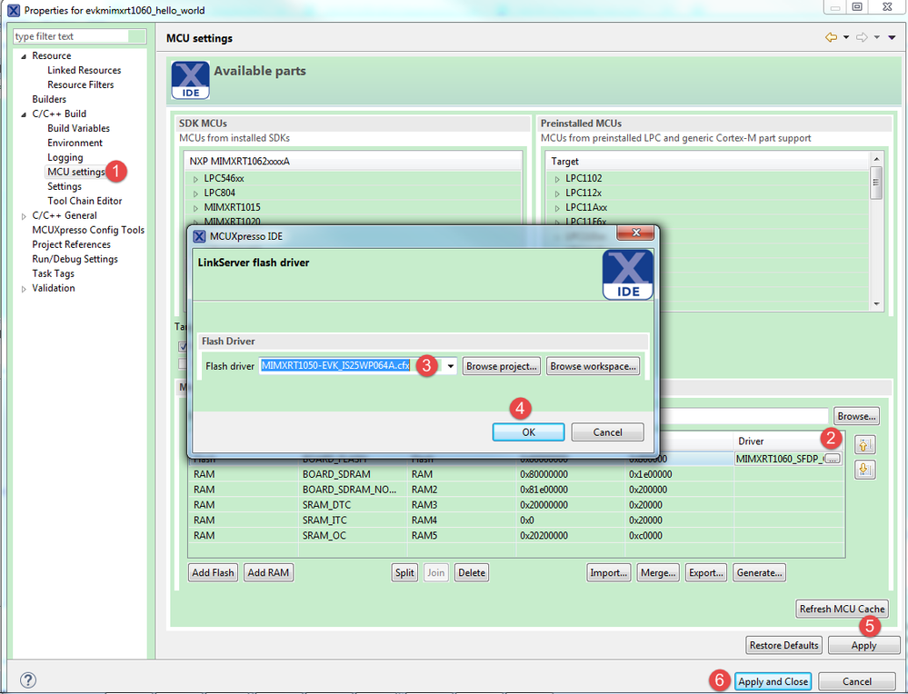

I have moved the 0ohm jumpers to utilize the NOR Flash on my IMXRT1050EVKB and thought I have installed the proper firmware but when I try to write the hello-world program I get the following error.
Driver V.2 dynamic startup failed - driver Init provided no flash parameters
Flash Driver V.2 startup failed - rc Ef(55): Dynamic flash driver startup failed to provide flash parameters.
Terminate (0x0, 0x0, 0x0) status 0x40 - driver reports init failure - EXTSPI driver rc -1 (0xFFFFFFFF)
chip initialization failed - Ef(55): Dynamic flash driver startup failed to provide flash parameters.
failed to initialize flash driver MIMXRT1050-EVK_S26KS512S.cfx
Can anyone advise where I can find the proper driver to fix?

Regarding your issue, if you assue that your hardware setting is 100% correct.
I find you use the MCUXpresso IDE, please check the appropriate flash driver (MIMXRT1050-EVK_IS25WP064A.cfx) is selected as the Fig 1 illustrates.
