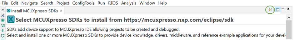

I am unable to install any SDKs. I get "Unable to load SDK update site or SDK update site not set". Firewall has been disabled. I have installed v11.6.0.

Just for double check, are you still having issues after clicking the refresh button? Sometimes the internal SDK repository could be slow depending on demand.

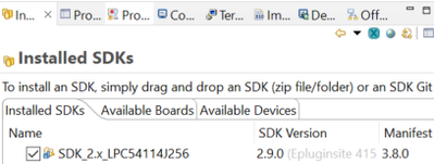

Also, you can install and access MCUXpresso SDKs from Welcome | MCUXpresso SDK Builder. Here you can download the SDKs you need as ZIP files. Then just import the SDK, simply dragging and dropping your ZIP file in Installed SDKs in the workspace:

While I am not able to download SDKs, I was able to install them the "Offline" method.
