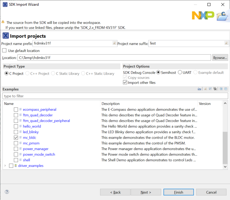

The MCAT part generated by wizard shown in the following screenshot is totally broken. The generated project files are attached. It seems no one has ever tested/used it.
Here are problems:
1) Totally disorganized files
     The HTML files used by FreeMaster are in directory: mc_bldc_Test\doc\motor_control\freemaster\bldc\mcat\src, while the needed JavaScript files are in another directory: mc_bldc_Test\motor_control\freemaster\bldc\mcat\src\JS_functions. Therefore the following line in  MainPage.html won't work:
        <script type="text/javascript" src="JS_functions\mainInclude.js"></script>
2) After manually put HTML and JS files in right place, no menu tab was visible
3) After further investigation, I found a bigger problem, the HTML/JS files for FreeMaster are outdated, and won't work at all in the latest version of Windows 10, where Microsoft browsers are now chrome based. For example, "parent.document.getElementById(...)" is widely used in JS to access HTML elements in parent window, however, now in new chrome based Microsoft browser, parent.document is not accessible anymore, so the MCAT app won't work at all.
May someone in NXP please fix the MCAT app?
Here are some info of my testing environment:
Windows 10 version: version 1909 (OS Build 18363.959)
MCUXpresso IDE v11.1.1 (Build 3241) (2020-03-02)
FreeMaster Version 3.0.3.6
Bob

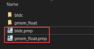

FelipeGarcia
Hi Bob,
In order to run MCAT tool please make sure you have unzipped the SDK package. Once you have done that you have to open one the following Freemaster project depending on your application.
Path: SDK_2.8.0_FRDM-KV31F\middleware\motor_control\freemaster
Please let me know if you have any issues.
Felipe
