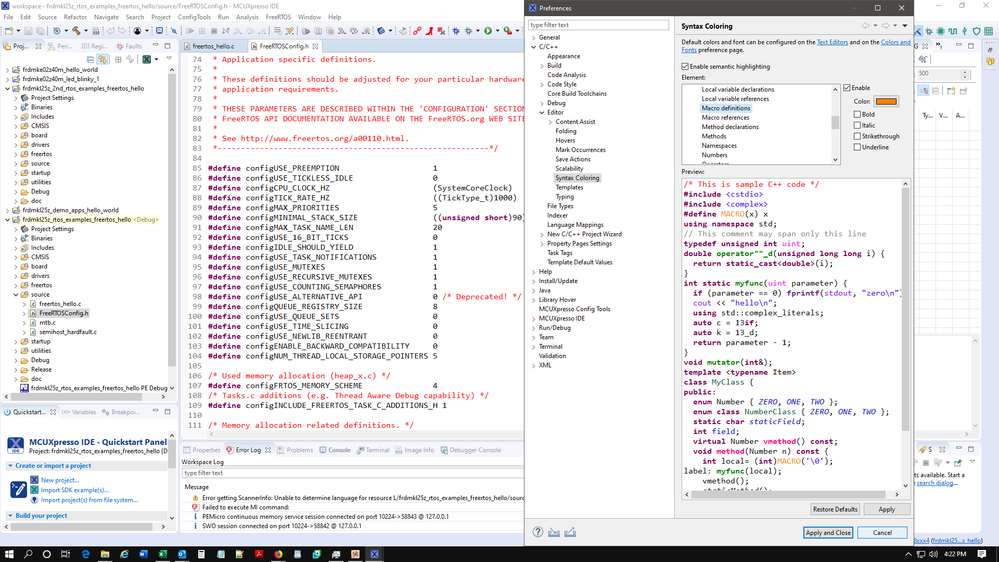

Yes, Macro's and everything else not coloring.  I am also using IDE 11.0.1. I have even re-installed once again already.

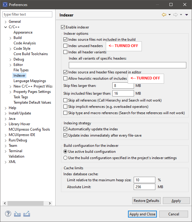

Before trying the re-indexing rebuild, I did the following under preferences with no luck.
I then performed a index rebuild.  No change.
I think of some interest though, is the warnings and errors I get right out of the box when simply starting Xpresso, shown here.  This is initially what I was trying to resolve with a re-install.  I have no clue if they are normal or unimportant.
The next item of interest is when I open a header file to see if any coloring has changed and the "Warning" that says "Error getting ScannerInfo: Unable to determine language for resource L/frdmkl25z_rtos_examples_freertos_hello/board/board.h"
This seems to indicate that it does not know what language is being used....and therefore I assume it doesn't know how to apply coloring?  Is this the problem?  How/where would it be corrected?  Why would it not know from example code right out of the box?

There might be a problem with the project itself: or do you see the problem for other projects too?
There seems to be a severe problem with the plugins doing the scan.
And the duplicate id thing in the message indicates a problem with the installation too.
Could it be that you 'over-installed' the IDE into an existing installation/folder?
Or are you sure you installed into an empty folder (should be the default)?
To check if it is a problem with the project: could you share it here?
