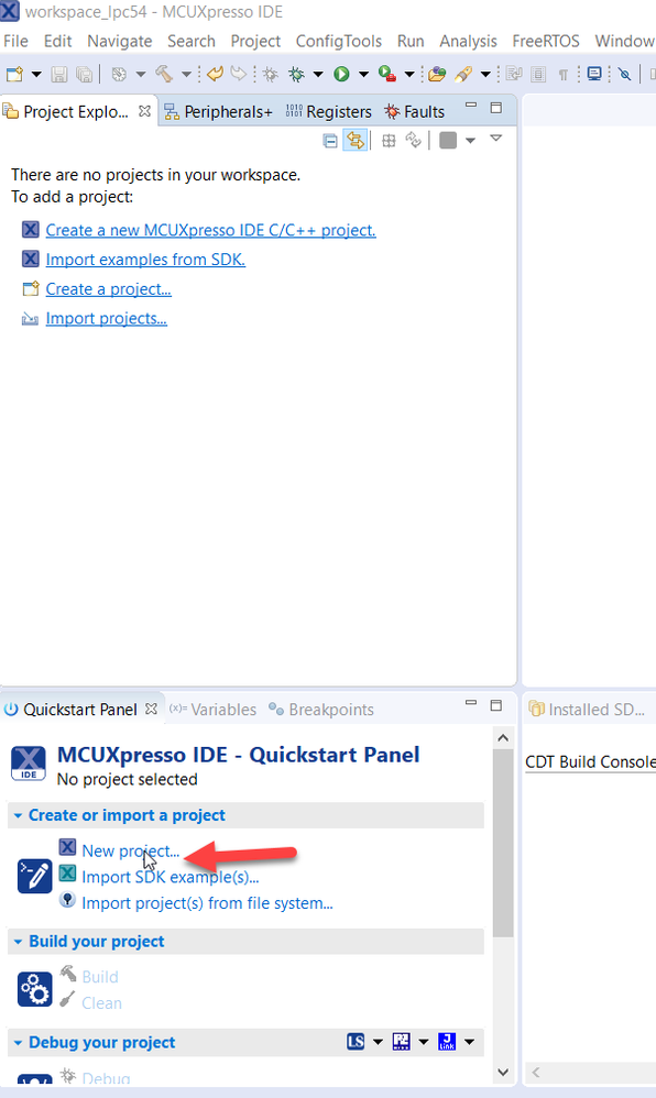

Please follow the below steps:
1. Click on New project

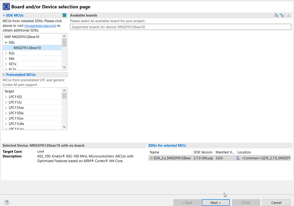

2. Select the MCU from installed SDK, click Next
3. In project, Options select UART and add the uart driver
4. Select Redirect SDK "PRINTF" to C library "printf", then click Finish
5. At this point, you should be able to use printf.
Please check the fsl_uart.h
You will find the structure with the settings for all of the UART interrupt configurations.
